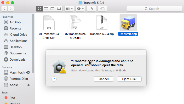

Hello,
I am having this problem trying to run Transmit 5.2.4
Any idea why i am getting this error message?
MacBook Pro (13-inch, Mid 2012)
macOS 10.13.6 (17G6030)
Thanks
Camelia
Though I haven't seen Transmit come as a folder download perhaps this can help?
Code:
sudo xattr -rd com.apple.quarantine /Applications/Transmit.app

That usually happens when the app is cracked. But it could happens even if the download is corrupted or the app is not properly signed. Try to download it again, and if doesn't work, contact Panic.

@camelia I would suggest too, like the comment above, to re-download the software. Perhaps trying a different browser and also try using an alternate unarchiver.

Try using the free Keka unarchiver from www.keka.io or The Unarchiver from the Mac App Store. I'm not saying that it absolutely does help - however, I do have experience with unarchivers other than the macOS built-in performing the unarchiving "better". I'm not sure why it helps in some cases but it might. Keka has recently become my default - having tried it over the years I think I have settled for it this time.

Update:
if I type in terminal sudo spctl --master-disable the .app opens and runs
What If could mean? the app is not properly signed?
The app contains malware?

I don't think it's malware infected - I just think that gatekeeper has a different point of view about the app. Sometimes the app opens upon right-click and selecting Open - with gatekeeper on. That's what I've read.

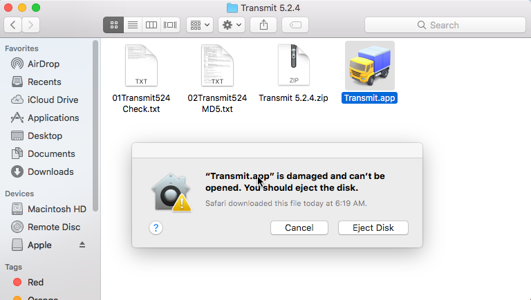

Hello,
Thanks
Camelia

Oh! those extra .txt files are my license and the checksum to verify the app, in my USB

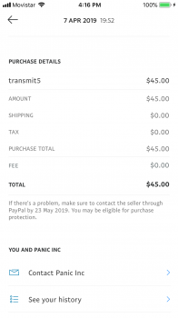

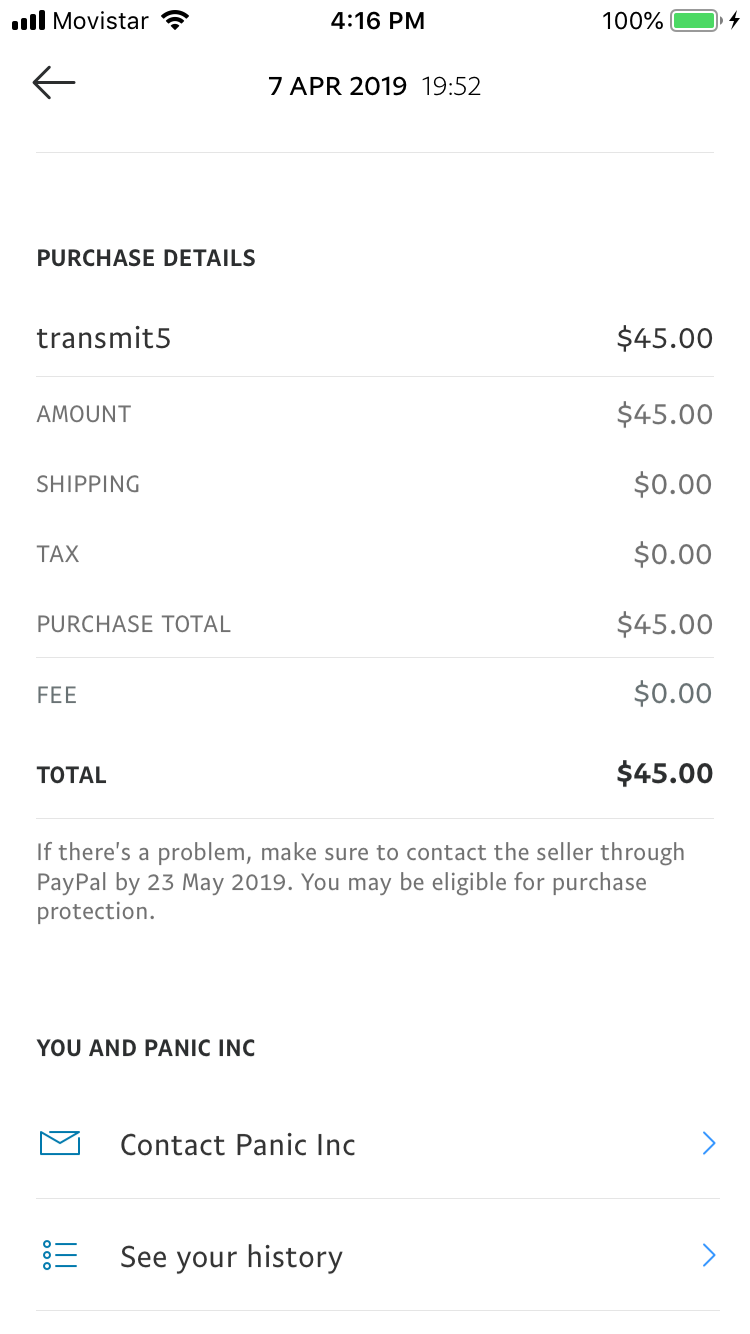

Thanks to all I am going to ask for a refund

Since I did not see anyone else mention that, would you kindly try a fresh download one more time, and then after it extracts, move the truck to the Applications folder, and then see if it starts without a hitch? It appears you are not moving it to the Applications folder, and what harm might come from trying once?

Yup, fresh download, moved to Applications Folder
Same issue 😡
