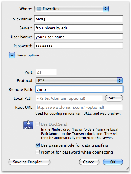

Hi MWQ.
When you create a new Favorite, there'll be a blue downward pointing arrow (see attached).
Good luck 😉

Thanks Southernboy,
I am making progress thanks to your superbly illustrated instructions.
Of the five websites I'm webmaster for I can now access two from my Mac. Progress!!
For the others I get "server not found" - which is odd since I can access them through my PC ftp program. I've checked all the access details again; I have purchased the full version of Transmit ...can't think where I'm failing.
