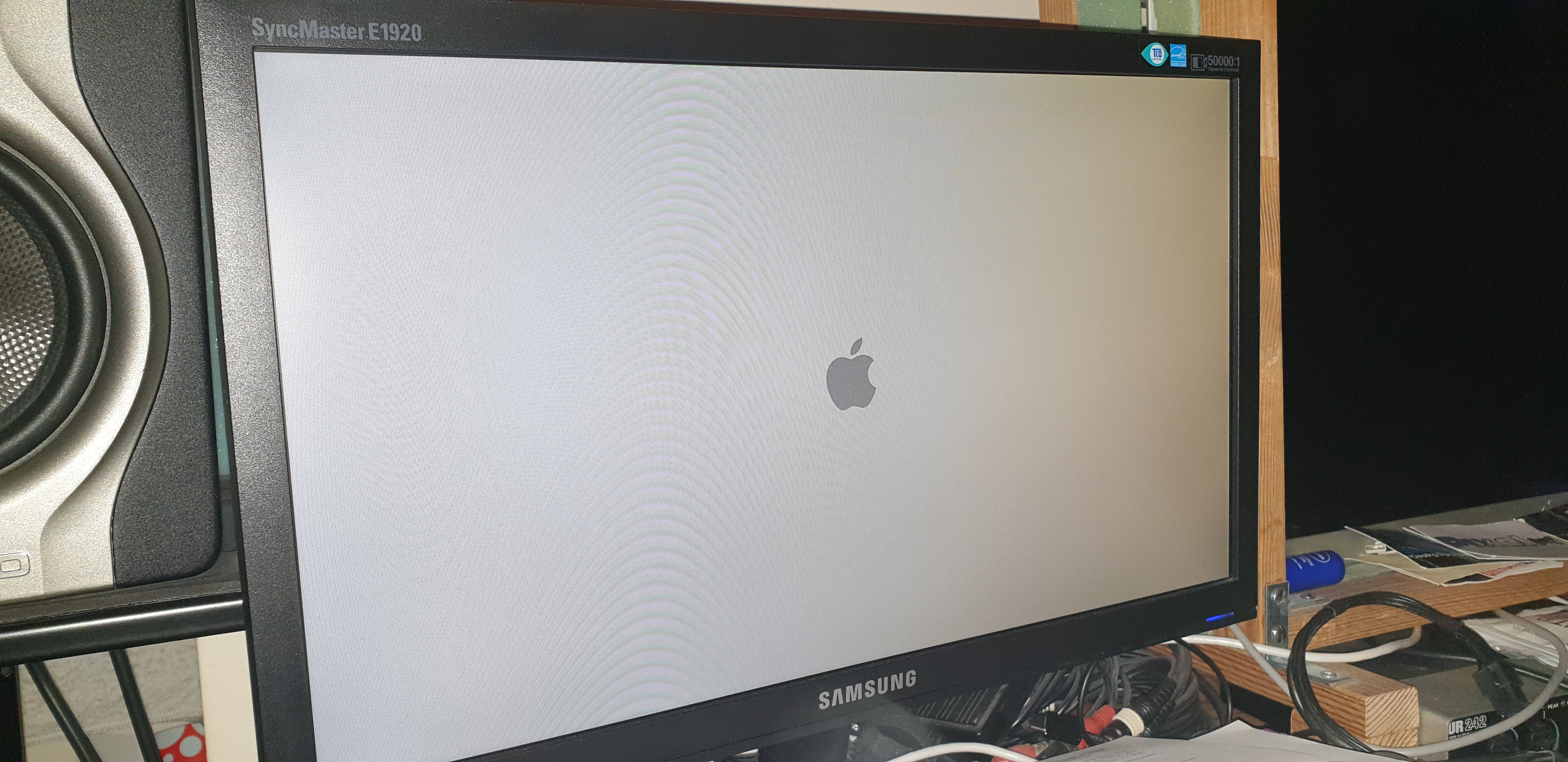

I have managed to get a bong white screen an apple logo and the bar starts to load the off
[doublepost=1550252491][/doublepost]I'm up to this screen should I go recovery or normal boot HD

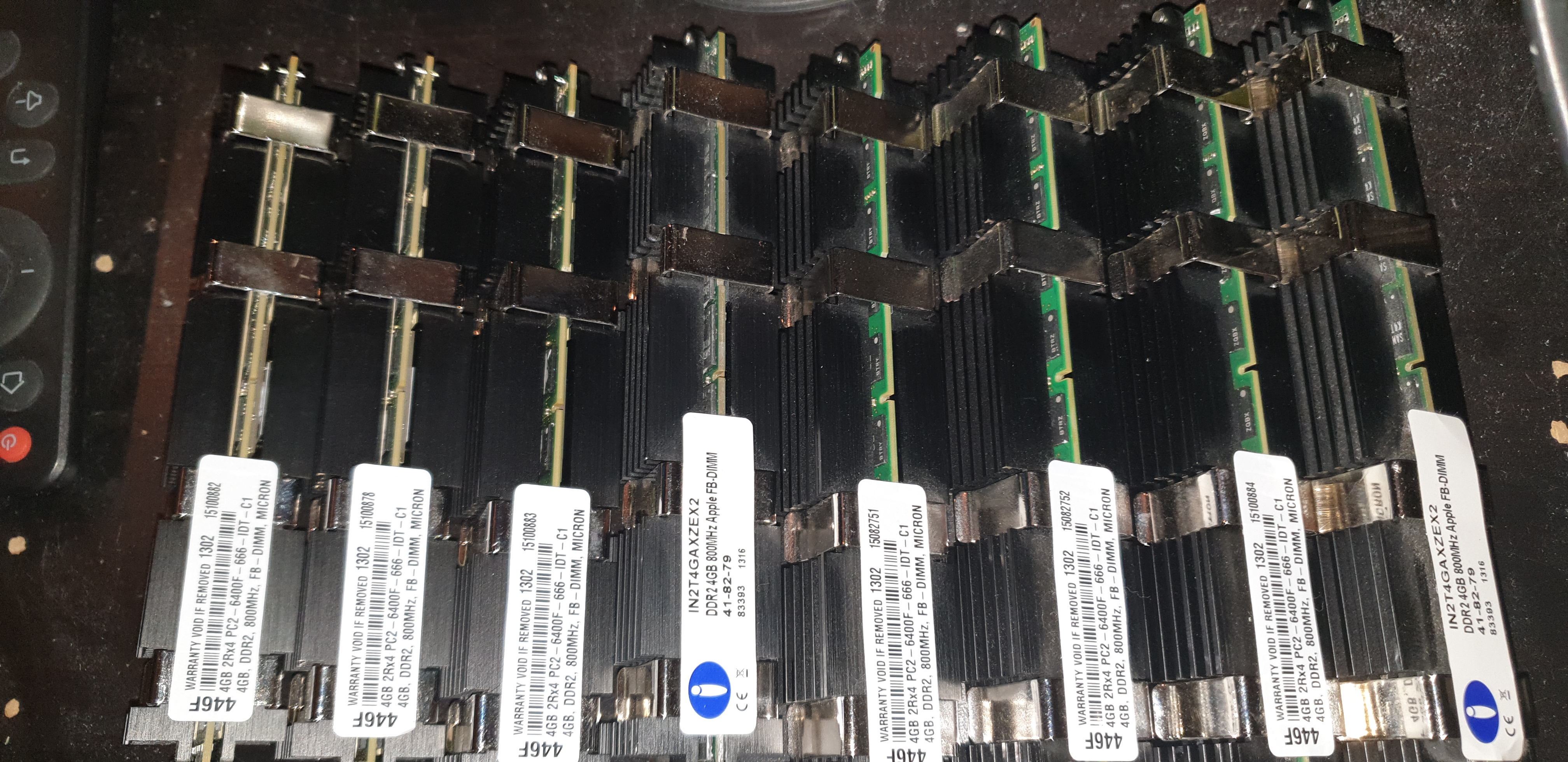

****ing yessssssssssss took 32 gigs of ram out put in the original 4gb and pow its alive

Bum stick of ram. Lovely. At least that’s better than a PSU. Glad you got it resolved. Try each one to find out the culprit and bid it a fond adieu.

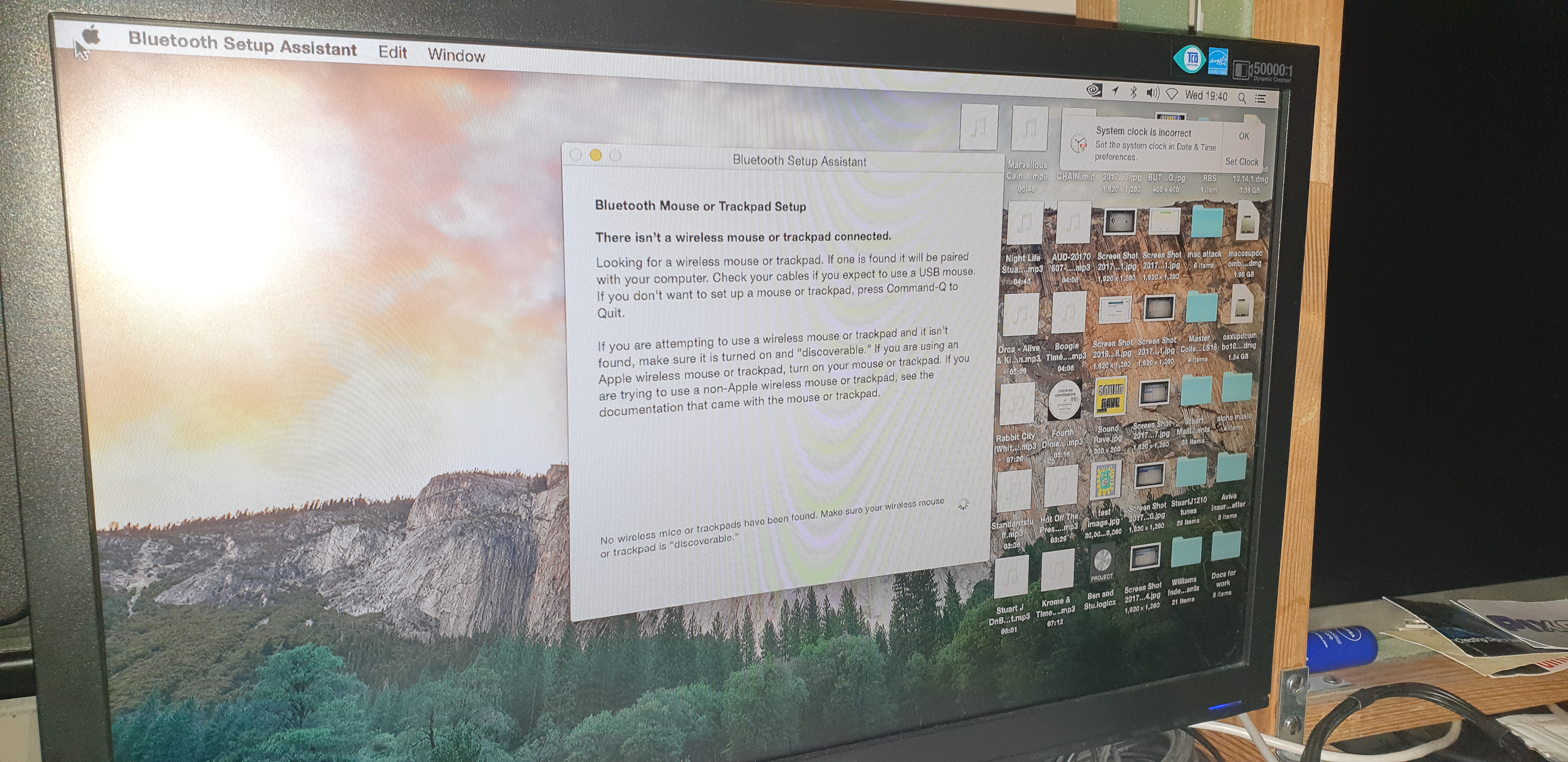

Just was reviewing some posts and not sure if you ever got this solved. One of your screenshots is showing a system clock error which I didn't notice before. This is usually the battery on the logic board being dead and a replacement can fix erratic behaviour like you're having.
