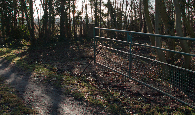

I've had a go with the pen tool and found it is fairly easy to do, however, I'm not sure how to edit the 'in-between' parts of the gate (grid part) as it will look like I've just cut it out?
Also, I see what you mean about the hearse, Google images hasn't provided many different angles 🙄
Thank You
EDIT: I've attached the original (cropped) to show better the gate...

You're doing great with the fence... keep it up! Use pen tool on vertical bits of fence like you did with horizontal. Sure, there are many more clicks involved there, but... "If it were easy, anyone could do it." Have fun with it!

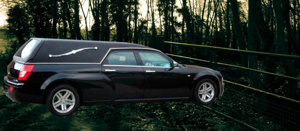

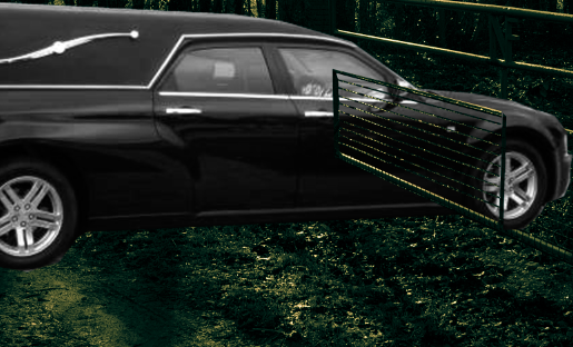

Hmmmmm.
Judging by the pic you just sent, perhaps the hearse isn't too far away but actually too close. 😱
Try this for an idea of where it could go.
Also try to use the polygonal lasso tool on the gate/fence and save the selection. Then copy it from the original and paste it into a new layer on top.
Edit: Why is the hearse going "off road" though? 🙂

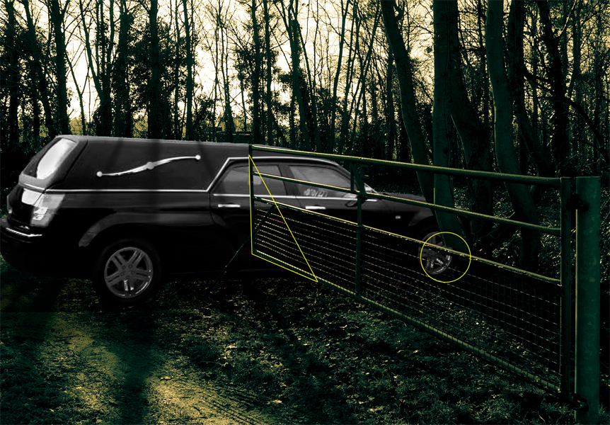

Looking good!

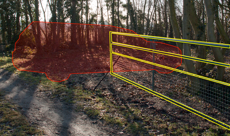

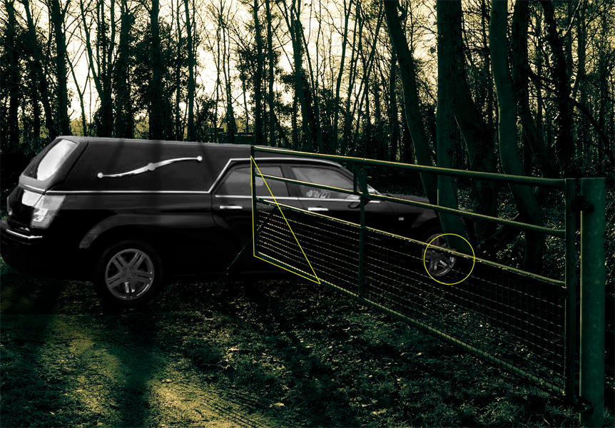

Have a look at the two areas I highlighted.
The gate right next to the car will have a shadow falling over it — more or less inside that yellow triangle. There won't be any highlights on the gate.
(And the hearse will also have far less bright refelctions, but I don't know how you will reduce those without losing detail.)
Check the tree inside the yellow circle.
You have lost part of the trunk at the base and it now looks as if the wheel has crashed into it.
Small stuff, I know. 🙂
But if it is worth doing…
Good luck!
