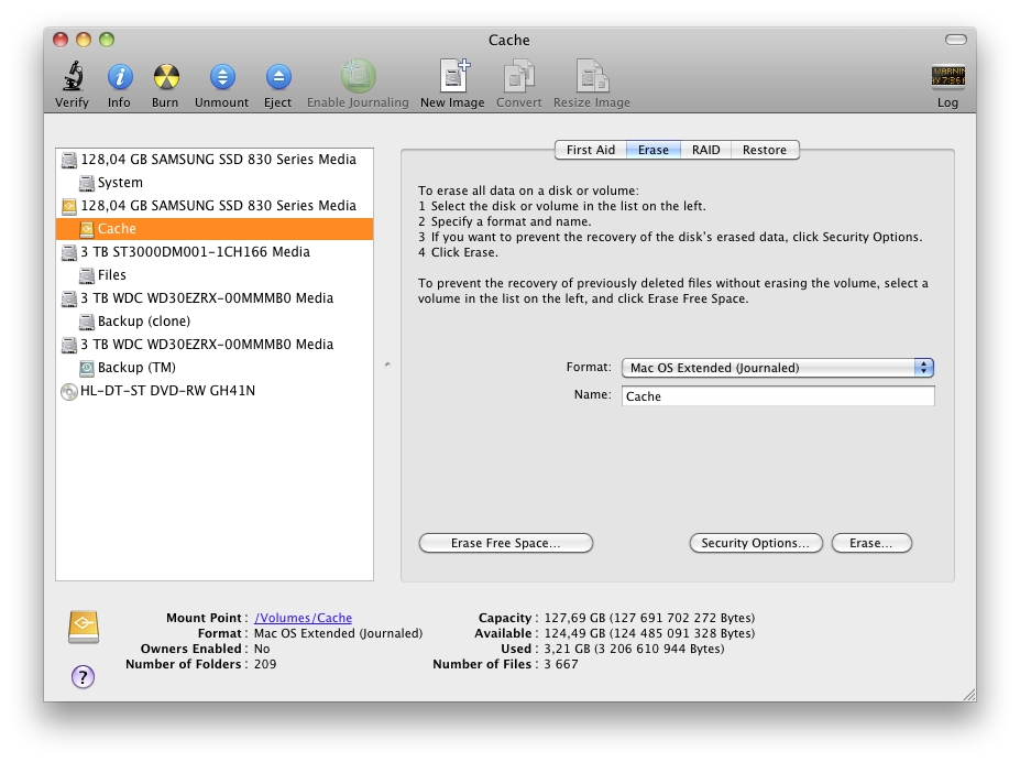

By the way, is fsck -fy the same thing as clicking on "erase free space" in "Disk Utility"? As you can see below both SSDs can be accessed there, unlike when booting into safe mode.
Perhaps TRIM only gets passed to drives on the native SATA ports or drives that operate natively without added drivers? Or your particular PCIe card is not passing/supporting the TRIM command?
No, they are not the same. fsck is a command that checks disk integrity and partition/folder structure as well as running TRIM on unused space.
The erase free space only does one thing. It makes a large, empty DMG file that fills the free space, then it deletes that DMG file. This also needlessly adds a SSD write cycle to your disk. The erase free space command also takes forever to run because that large DMG has to be created.
Ah! That's my experience exactly -I tried it and it took 25 minutes with my new 128GB drive which has 124GB free.
In comparison, the "old" boot SSD (also 128GB but with 100GB free) only took a few seconds to do with "fsck".

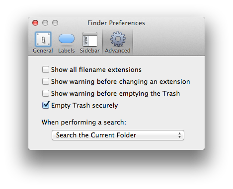

So if the said files were passed to the trashcan then a "Secure Empty Trash" operation would essentially be the same thing as using Trim?

I'm not sure what a Secure Empty Trash does... I suspect it just overwrites the blocks with all zero's or one's and perhaps wouldn't help at all.
No. The 'Secure Erase' command does not write zeros. TRIM does not write zeros.
It's important to note that 'Secure Erase' command is an actual ATA command, https://ata.wiki.kernel.org/index.php/ATA_Secure_Erase
vs the ad-hoc 'secure erase' procedure that has been around since the advent of spinning drives which involves one or multiple passes to write over the drive.

From the OS X Manual:
Secure Delete
When a file is put in the Trash and the Trash is emptied, or when a file is removed using the rm UNIX tool, the files are not removed from disk. Instead, they are removed from the list of files the operating system (OS) tracks and does not write over.
Any space on your hard disk that is free space (places the OS can put a file) most likely contains previously deleted files. Such files can be retrieved using undelete utilities and forensic analysis.
To truly remove the data from disk, you must use a more secure delete method. Security experts advise writing over deleted files and free space multiple times with random data.
Mac OS X Server provides the following tools to allow you to securely delete files:
  • Secure Empty Trash (a command in the Finder menu to use instead of “Empty Trash”
  • srm (a UNIX utility that securely deletes files, used in place of “rm”)
And when I examine the space it's not random, but all zeros. So even tho the manual says "Security experts advise writing over deleted files and free space multiple times with random data", Apple is writing zeros when "Secure Empty Trash" is selected (at least for the last pass). 😉 I didn't test "srm" so I dunno if that's the same or not.
And i dunno what Trim does - thus I asked.
Yeah, zeros... Isn't that what Trim does tho?
Right, so a secure delete which overwrites data with one's or zero's protects the recovery of deleted data but does not help SSD garbage collection since there's still no information provided to the drive's controller that the NAND blocks are released.
Secure deletion should not be confused with Secure Erase or TRIM.
