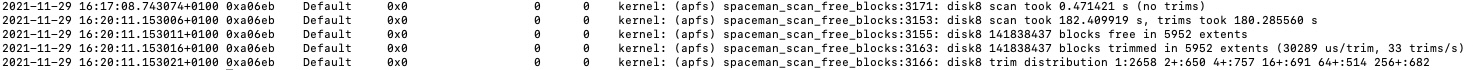

I checked my logs and indeed TRIM is being run on both of my 2.5-inch SSD enclosures (both of them are rather cheap Chinese models). TRIM appears to be triggered after plugging them in as well as every 15 minutes if the disk is in idle. Good to know! The screenshot shows my external 1TB Final Cut SSD (ADATA SU650).
Reactions: Basic75
On disk utility does it say as Solid State? And what Chip is it using? The enclosure chip.
Solid State says "No" in Disk Utility, so apparently that doesn't matter.
Chipset appears to be a JMicron JMS578.

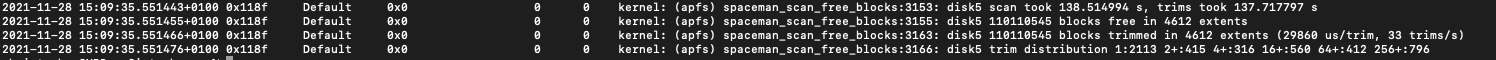

Interesting. it does trim my TM drives. So i do know my TM backup drives enclosure supports UASP since i can see it's connected using UASP on my Mac. And since my drives (2.5inch Seagate with 2TB of capacity) is an SMR drive which supports trimming. It actually trims it. that's actually pretty cool.. I think that's actually one of the reasons why it takes a long time to format the drive back when i got the new MBP 2021.
2021-11-29 06:15:44.686475+0700 0xb7a35 Default 0x0 0 0 kernel: (apfs) spaceman_scan_free_blocks:3153: disk7 scan took 78.020216 s, trims took 73.999477 s
2021-11-29 06:15:44.686481+0700 0xb7a35 Default 0x0 0 0 kernel: (apfs) spaceman_scan_free_blocks:3155: disk7 395446431 blocks free in 3761 extents
2021-11-29 06:15:44.686485+0700 0xb7a35 Default 0x0 0 0 kernel: (apfs) spaceman_scan_free_blocks:3163: disk7 395446431 blocks trimmed in 3761 extents (19675 us/trim, 50 trims/s)
2021-11-29 06:15:44.686495+0700 0xb7a35 Default 0x0 0 0 kernel: (apfs) spaceman_scan_free_blocks:3166: disk7 trim distribution 1:908 2+:382 4+:840 16+:607 64+:435 256+:589
