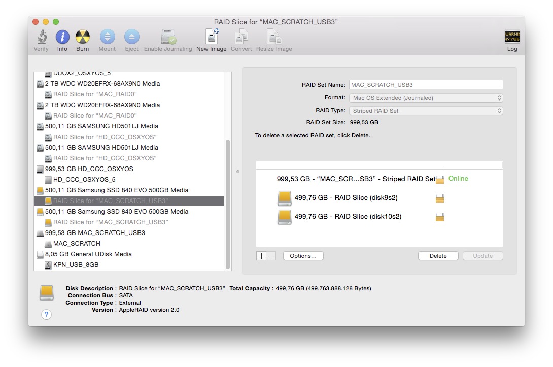

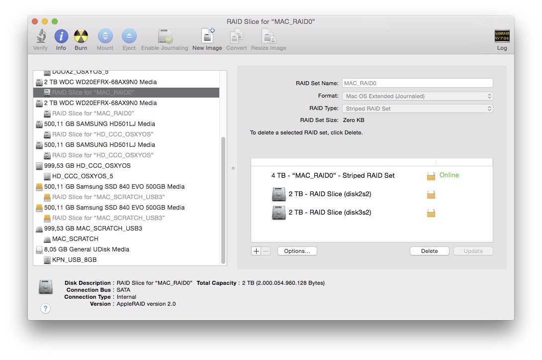

With the "sudo trimforce enable" in OS X 10.10.5, the Software RAID0 works perfect:
Internal bay RAID0:
External (USB 3.0 UASP) bay RAID0:
Hope this clarifies some setup and speed questions.
