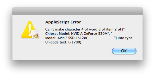

So, do I run the app or is there something I need to tweak before running it?
EDIT: Ran Get Model and it came up with AppleScript Error

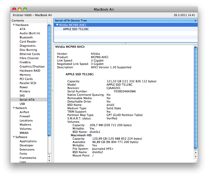

Last login: Sat Mar 26 14:40:25 on console
Kristian-Vatto-MacBook-Air:~ Krisu$ /usr/sbin/system_profiler -detailLevel mini | egrep '(Model): ' | cut -d: -f1-
Chipset Model: NVIDIA GeForce 320M
Model: APPLE SSD TS128C

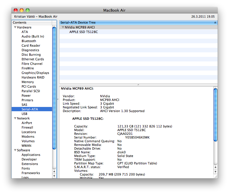

What OS where u on?
btw tried for myself and worked
does the SSD u have have TRIM support? i mean in the SSD itself?
