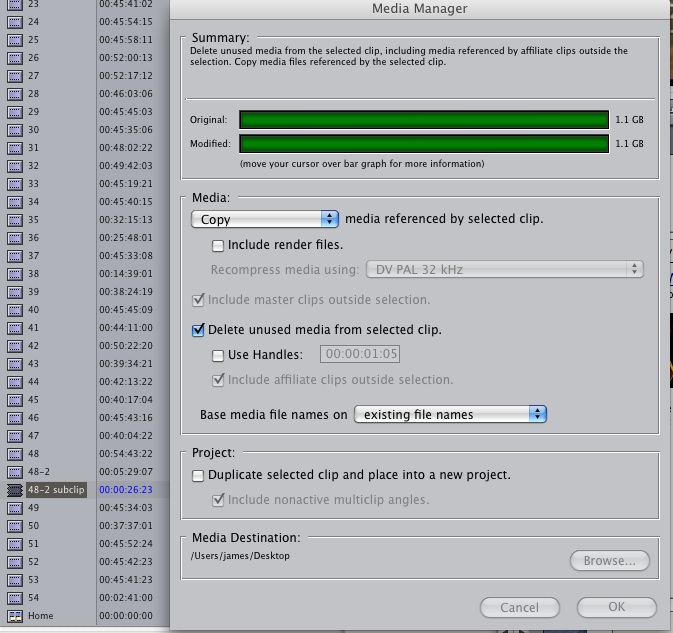

Followed your steps exactly yet still the green bars remain the same length! I've attached a screenshot showing what I see. (looking at 48-2 at its subclip)
Of note, include affiliate clips outside selection and include master clips outside selection are both ticked and grayed out - is this what is stopping the resize? If so, how to I access this option?
