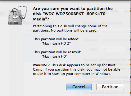

When I try that I get this (See Attached)
And it does not boot into BootCamp Anymore, I have also heard about reFit, does it work on Lion?

Hmm, interesting.
From what I can see, rEFIt works if you manually install it, though I haven't manually tested that. I guess when you repartition, it messes up the hybrid GUID/MBR map that Bootcamp sets up, didn't know that.
jW
Before you did your partitioning, OS X is in disk0s2 (or some other disk0s#), and Windows is in disk0s3.
After you did your partitioning, OS X is in disk0s2, your new partition is disk0s3 and Windows is now disk0s4. The problem is that Windows still thinks that it is in disk0s3, and that is set somewhere in the OS when it was installed. So it doesn't boot now. There may be a guide on how to change that on Google. Else, reinstall Windows.
