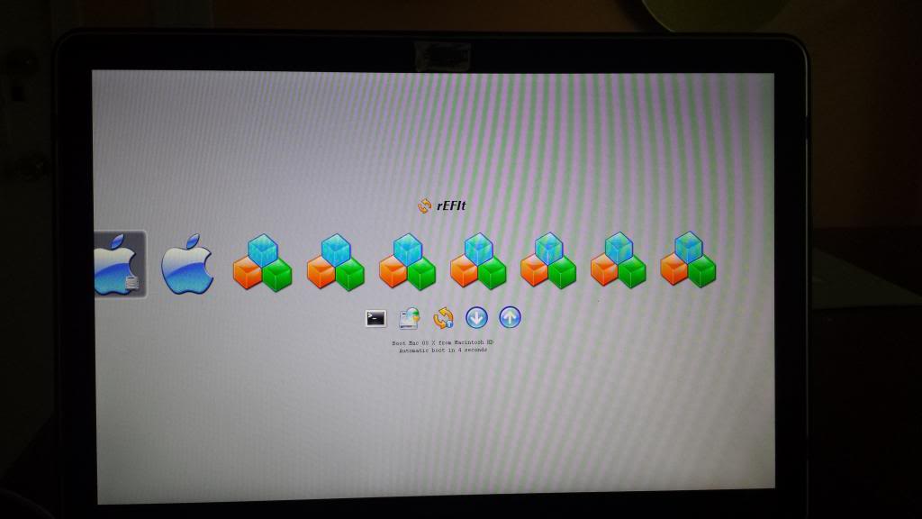

Hello everyone,
So I followed this guide on how to triple boot a Macbook Pro:
http://lifehacker.com/5531037/how-t...-with-windows-and-linux-no-boot-camp-required
I have a 15 inch mid 2010 Macbook Pro (the first generation i5 processors). Before I came across that guide, I have had already used Bootcamp to create a Windows 7 partition. Then I installed reFIT and used that guide to install Fedora 19. Now my proccesses didn't go exactly as the guide went, I ended up with some "unallocated/free space" after partition through Mac's Disk Utility, and used that to install Fedora 19(Fedora installation for some reason would not recognize the partition I had specifically made for the install)
I can still access my Mac partition, and I am accessing my Fedora partition, but I cannot get into my Windows 7 partition now. Everytime I hold Option, and boot into reFIT, I get this screen (see attached image):
I can still select Windows 7 partition if I go all the way to the right off the screen, at the bottom it will say that Windows 7 is selected. Once I select Windows, I get the "No Bootable Device -- insert boot disk and press any key" error message.
I went back into my Mac partition, went under Disk Utility and my NTFS partition I used for Windows is still there.
Any help will be greatly appreciated!!!
In my view that guide is potentially disastrous.
It is likely that your Mac came with an EFI partition, a Mac OSX partition and a recovery partition. So, 3 partitions on the hard drive.
As soon as you create a Bootcamp partition (or a partition with a MS-DOS partition type, in Disk Utility) a hybrid mbr is created. This hybrid mbr is a different partitioning scheme than GPT, which is what your Mac originally came with. That's ok, because the 2 schemes can sort of run side by side.
The problem arises (once you have 4 partitions) when you either re-size an existing partition, or create a fifth partition.
This is because the mbr partitioning scheme can only handle 4 primary partitions.
So, even though you may have 5 or more actual partitions (which is fine for the GPT side of things), only 4 of those can be addressed/recorded by the mbr side of things. Any other partitions will not appear in the mbr and as such will be considered free space by any non-GPT-aware partitioning tools (i.e. Windows, for instance).
This is potentially a big problem.
It may be that your Windows partition has been dropped as one of the 4 that the mbr can handle and is therefore no longer bootable.
My suggestion would be to backup everything you can, by whatever means, and wipe the disc and start again with fresh installs, bearing the above information in mind.
Alternatively there are several posts on here by member murphychris on this type of subject. There are ways of getting back into Windows (often) so it may be worth searching for some of his posts if you're desperate to get back into Windows.

Now that you bring it up, I have heard of the 4 partition "limit" on a hard drive, at the time of installing Linux I had completely forgotten about that.
I think that is what I'll end up doing soon (wiping the disc), but thank you for pointing me in the right direction, I will look more into murphychris' posts.
