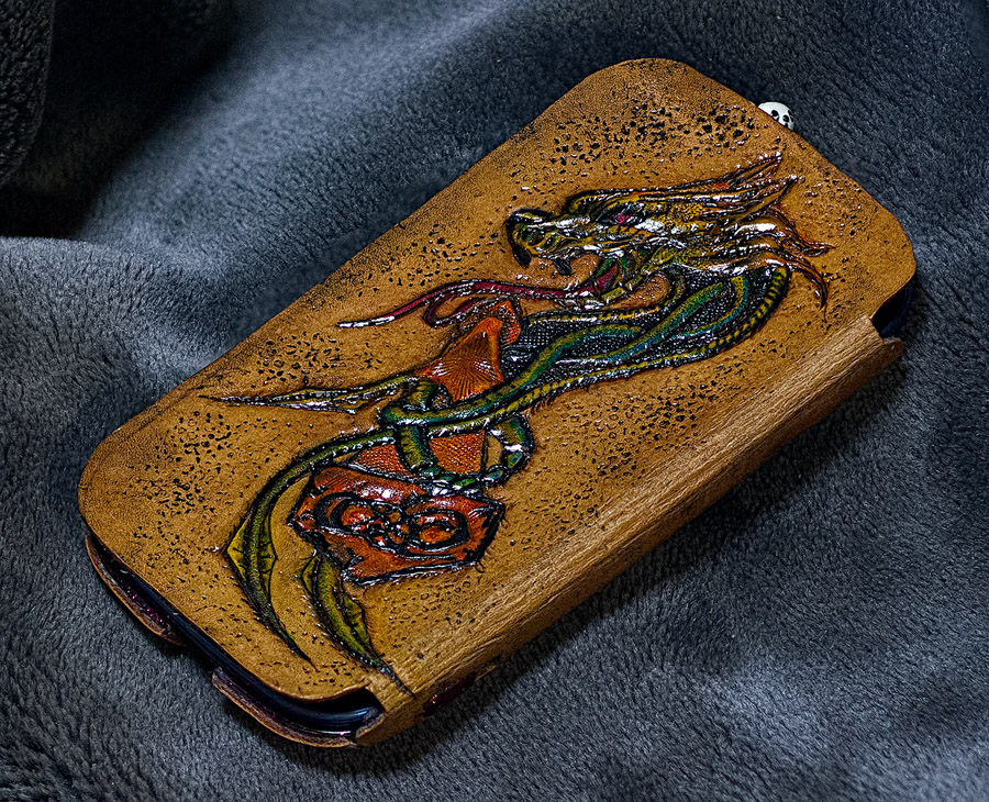

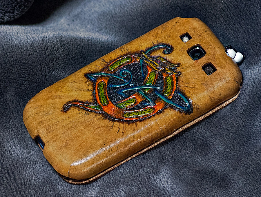

I'm a jack of trades I suppose: Page Layout (Artist/Manager), CGFX for film and television (Producer/director/artist-[modeler/animator/matte/comp]), Programmer (Application/Game/DB coder/designer), Music (composer/artist), Hardware (reseller/importer/designer-manufacturer), VOD systems (maintenance/design - SE), Camera operator (video/film/stills), Optical systems (maintenance/repair/sales) etc. it goes on... and even gets into manual labor like cabinet maker, framer (houses), roofer, boat builder, and so on. I've even recently been thinking about getting into custom leather carving. If you don't mind me bragging a little here's my very 1st project finished just a couple of months ago:

I'm a jack of all trades too, but I must admit I have a few less tools in my utility belt than you ("production" wise, music is probably the only thing I don't do). The custom leather work looks great! Thanks for sharing! I guess it's clear why you're an excellent Mac Pro candidate!
