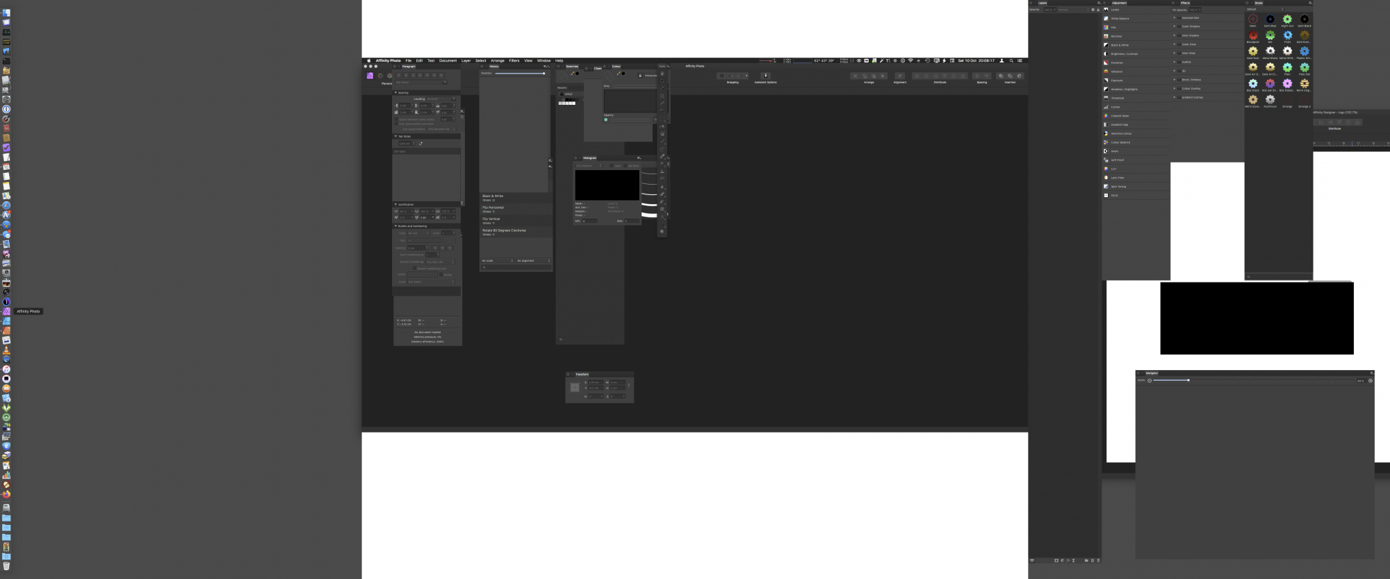

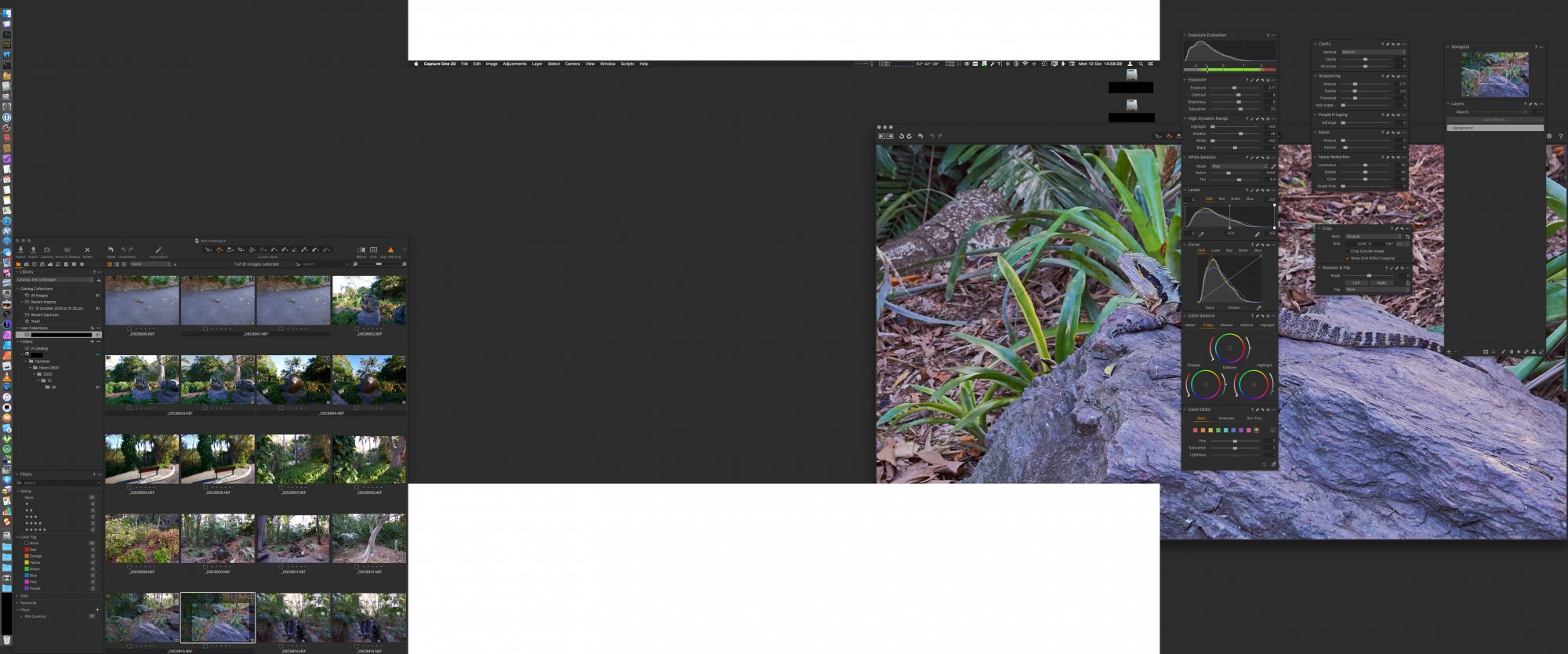

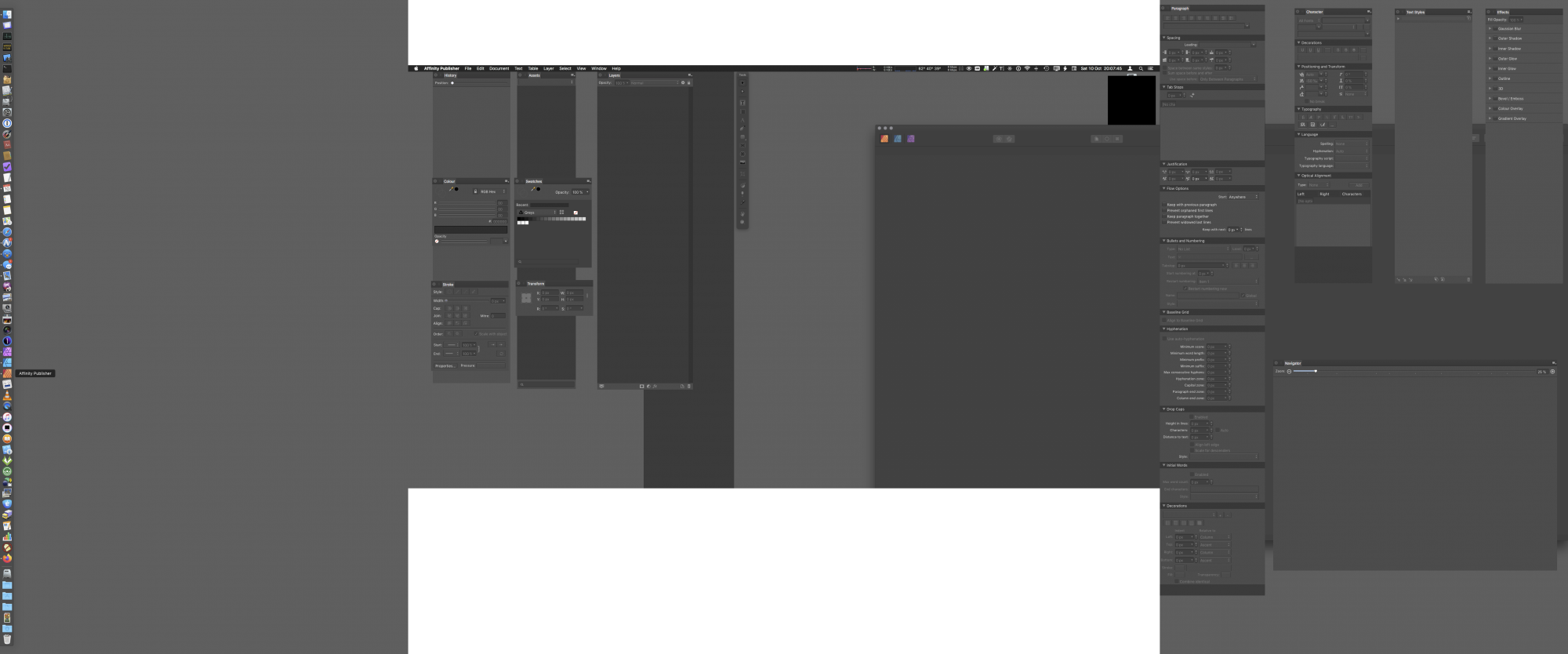

Symptom: on display wake, the sw240s light straight up, the sw270 takes about 5 seconds to get a picture. That happened even without the SwitchResX custom resolutons. However certain applications, eg Capture One, and the Affinity Suite seem to interpret this pause in the centre display weirdly, and lose the lefthand display, shifting their documents to a position in the centre of both the remaining screens, as well as pulling their palettes onto the main screen (sometimes placed above the menubar so that you can't get to their draggable parts).

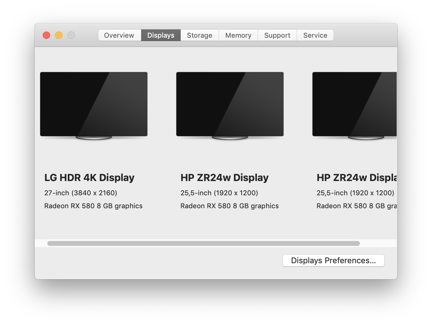

I'm also having issues similar to yours. Running tripple monitor setup with RX 580 on Mojave. When waking up from sleep the window configuration often gets messed up. Never found any useful solution rather than manually dragging windows back to it's original position.
I haven't had these problems when running High Sierra and GTX 980 with the same monitor setup and cables. So it's a Radeon/Mojave issue.
