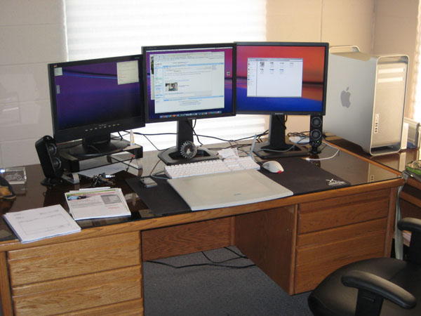

My Mac Pro at work. OSX is only limited by the amount of cards you can fit in the machine. Mac Pro's can do 8 screens, but the OS isn't limited.
does OS X even support three screens?
not even topline MacPros can run 3 screens
I invite you to check out this MacRumors setup, a Mac Pro with three 30" displays: https://forums.macrumors.com/posts/4069956/
I personally have seen a Mac Pro with 5 displays.
I don't know where you got the idea that an OS -- especially an OS used heavily by graphics and media pros!!!! -- can only handle two displays. Windows, OS X, and Linux all support many, many displays. I can't even remember what the theoretical limits are, but no one I've ever heard of has hit them. I really think, for pretty much everyone, that the only limiting factor is how many graphics cards you can fit in your computer.
