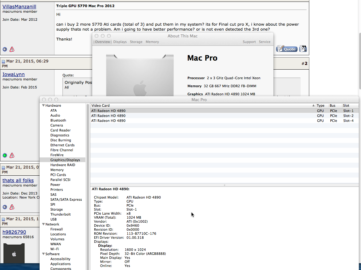

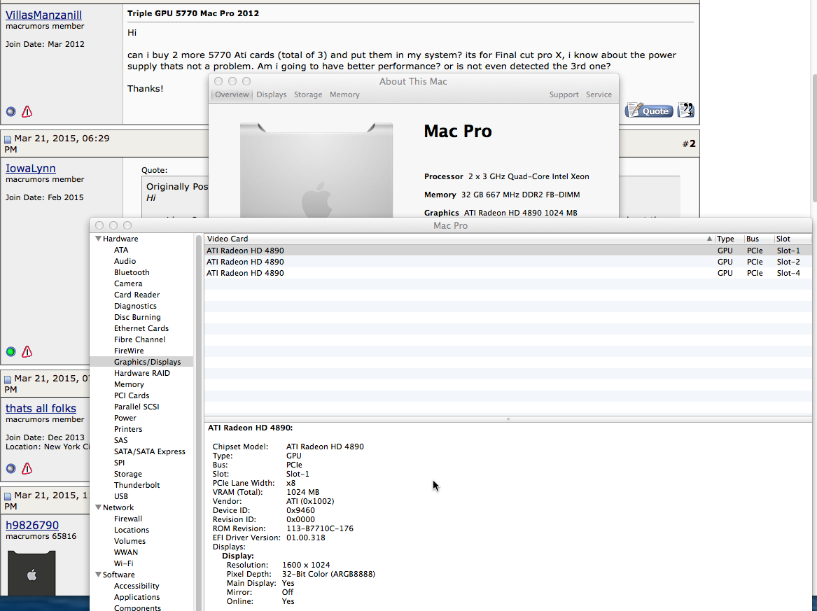

More likely than not, all three 5770s will be recognized, but my 4890 ATI cards in my 2007 MP (put there only to answer your question) are to old to use with FCP. To install three double width PCIe GPUs you have to remove hard drives 2-4, if any, and limit your HD storage, beyond HD1, to that in the optical drive bay. I use an FSP BoosterX, also installed in the optical bay, to power my extra GPUs. See, also - https://forums.macrumors.com/showth...mes+for+up+to+3+double+wide+gpus#post18872245 .
