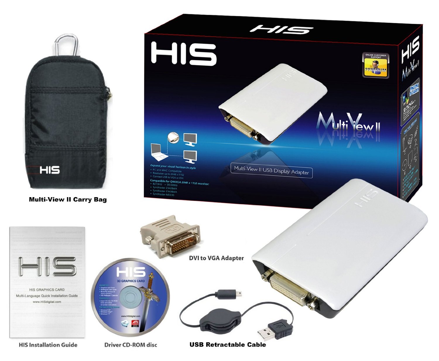

You can get a USB to DVI adapter to add 3rd monitor (and more) - though this monitor will be slower than the others. Good for palettes and email and such though. And the USB adapters don't support 24" monitors (max out around 1600x1200, not 1920x1200).

The second monitor via HDMI, the third on via one of those USB 2.0 to DVI/VGA adapters.

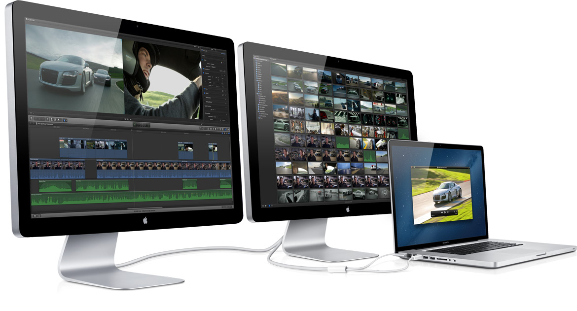

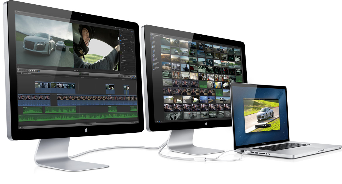

check out this image from apple's thunderbolt display page.
it shows 2 displays connected with one cable to a macbook. maybe this would also work by connecting the wire to a mac mini or iMac?
the setup in this pic is pretty sweet and should give you enough real estate
