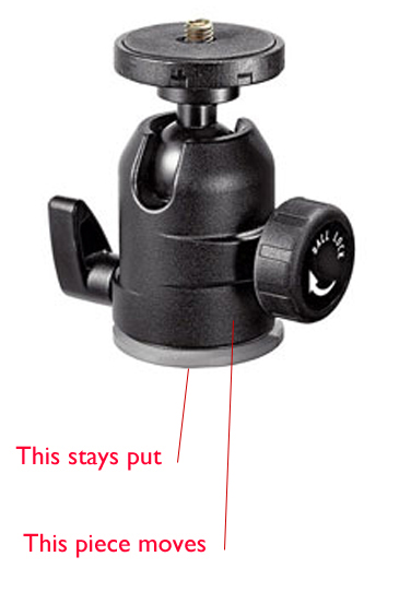

I just picked up a monopod and a 488 ball head, both from Manfrotto. The guide said that the small screws under the tripod head are locking screws. When the head is on you tighten them and they keep the base of the ball head from rotating. Mine has a plate with degree marks for pano shots. The set screws would lock the head base and allow the head itself to rotate.
Excuse me for being visual.
Dale
