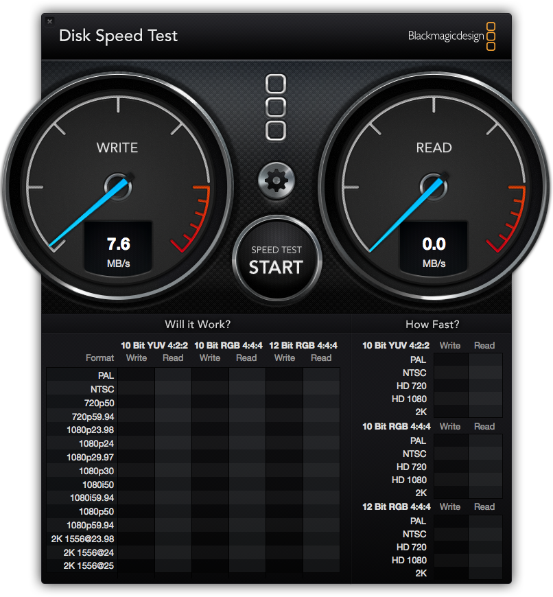

quick test via macbook/aes/500 mb wd usb2 external hdd
