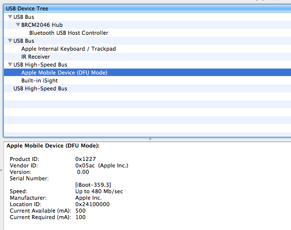

This is the line in device manager under "Device Instance ID" for the Apple Mobile Device USB driver:
USB\VID_05AC&PID_1227\5&1CBDCC8A&0&4
I thought that it was, but now I'm confused as to why I can't get the boot rom info...
Is there another method I can try on a jailbroken phone other than going into DFU and using Device Manager or the iDetector to find the boot rom info.
There are a couple youtube videos explaining this that are much more helpful than reading a procedure here are.
There should be a lot more info than just that line.
Here's mine for example on a Mac.
The iPhone presents as a good handful of different devices as it is booting, being reset, etc. I found this out when I was trying to use VirtualBox and Parallels to run the Windows version of limera1n. I swear I must have told it to connect 4 or 5 distinct devices to the virtual machine when I was trying to get it into DFU (including DFU/Restore/iPhone/etc). I think it presented even as a different device when it was just booting and in a state between boot and DFU. One or two of the devices only "existed" for a second, so ultimately I was unable to get limera1n to work through a VM.
