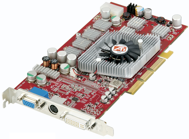

Post pic of the card, esp. sticker on the back with product number.

Card is not a Mac Edition. It's a PC DELL or Compaq OEM part. If it looks exactly like on picture (16 RAM chips or 8 on one side), it isn't even flashable.
Return it if you can, because it's not what you wanted to buy.

Again: is this card exactly that same as on pic you've posted? It's important.
Provide as much info as you can, otherwise I wouldn't be able to help. Post a link where did you buy it.

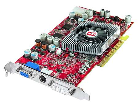

My card looks more like this. Either way, i was having tons of trouble trying to get this thing to work I just decided to return it and deal with getting a good card another time.
