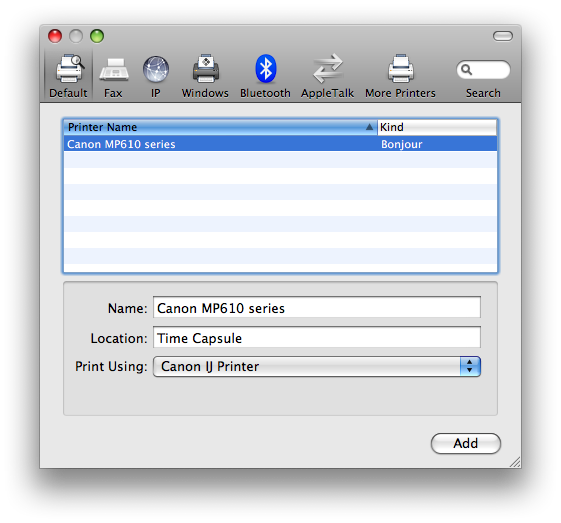

I have a the same AIO connects to a Time Capsule.
