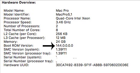

This:

Boot ROM Version: MP51.0084.B00
All I know is I had to do a firmware update to install the SSD PCIe card or High Sierra or something.
Looks like flowrider is on the right path, according to this article, you need a BootRom of 140/141/144.0.0.0.0 in order to boot from a NVMe SSD (which the Evo 960 is) from High Sierra. Newer BootROM versions are all numbers, you are at the older-style BootROM version. Double-check your SSD model - if you have a Evo 970 Plus, that's known to cause problems with Macs.
