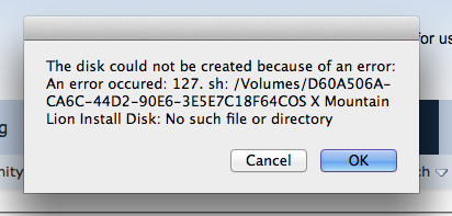

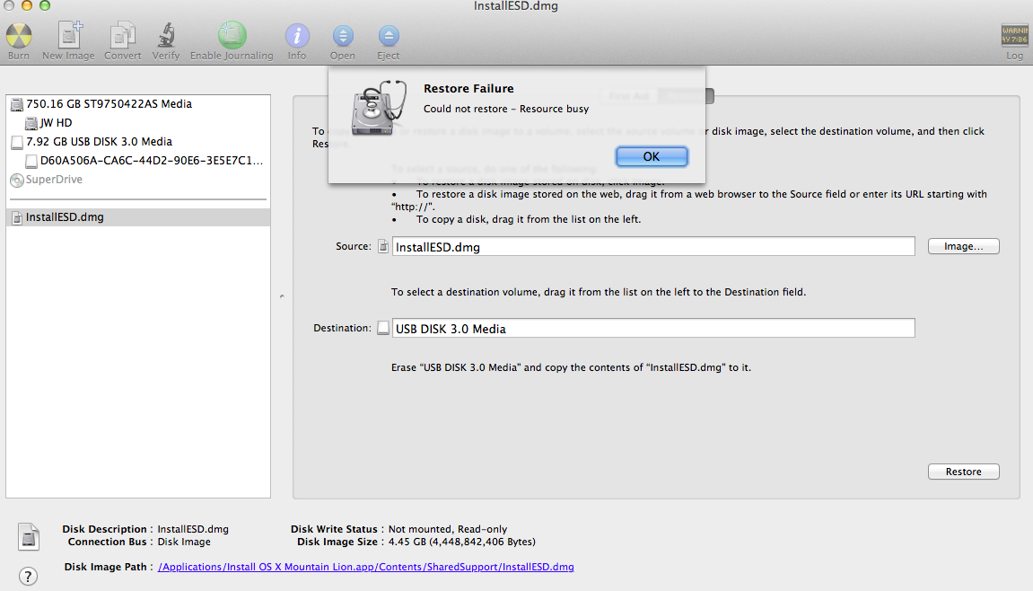

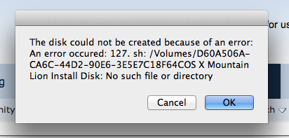

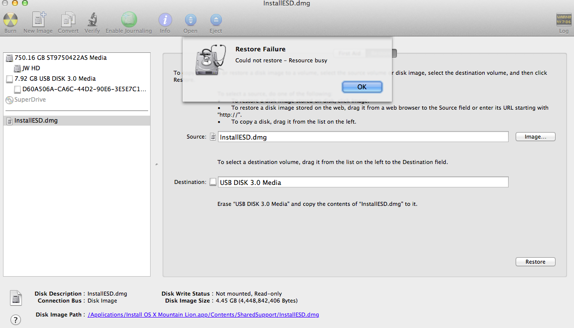

I'm trying to make a mountable usb drive of Mountain Lion.
I tried using Diskmaker X and tried it manually in Disk Utility; but I get the attached messages.
I've tried this on a Macbook running ML and a brand new 2012 Mini running Mavericks with the same results.
Any ideas?

Is that the same thing? I did try just using disk utility.
My goal is to install ML on 2012 Mini. I've been told this is possible with the bootable usb.

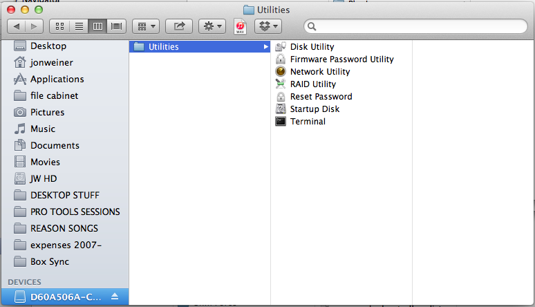

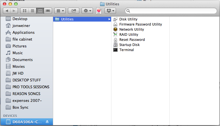

This is what I end up with on the usb:

I think the error stems from the name of your USB stick. I think if there are spaces in the name it won't work. I found this when I made mine yesterday.
I initially named my USB stick, "Install OS X Yosemite", the default name it game me an error. But when I named it "Yosemite" and I replaced "MyVolume" with "Yosemite" (below), it worked.

So I erased and renamed the usb drive "mountainlion" using Disk Utility. Then I tried Diskmaker and got the same error.
I then tried a restore in Disk Utility and it worked! Thanks!!
