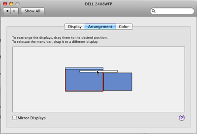

"Clamshell Mode" (external monitor, laptop closed) only works when connected to the charger.
You could run in extended desktop mode (dual monitors, no mirroring) which would let your external run at full resolution.
If you want the external to be the "primary" monitor (with the dock and menu bar on it) just drag the menu bar graphic from the laptop display to the external display in the display preferences:
