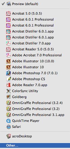

This may be a fairly simple process of repairing permissions (using Disk Utility in your Applications:Utilities folder) or, do a "Get Info" on the files you want to open. Under "Open With" make sure that the application you want to use is listed (or navigate to it using Other...) and selected. Then click on the Change All... button. You may need to do this for each type of file (each application in CS).

Oh, I'm sorry. I thought you meant that this was true for all applications. If this is a problem with CS, I think there is also a known issue / bug with Adobe CS. If you only have this issue with CS, that may be the problem. If I understand this bug, it can be triggered suddenly, and thereafter you see the issue you described.
Let me find you a link....
Here: Please see if the directions in this knowledge base note help:
http://www.adobe.com/support/techdocs/329996.html
