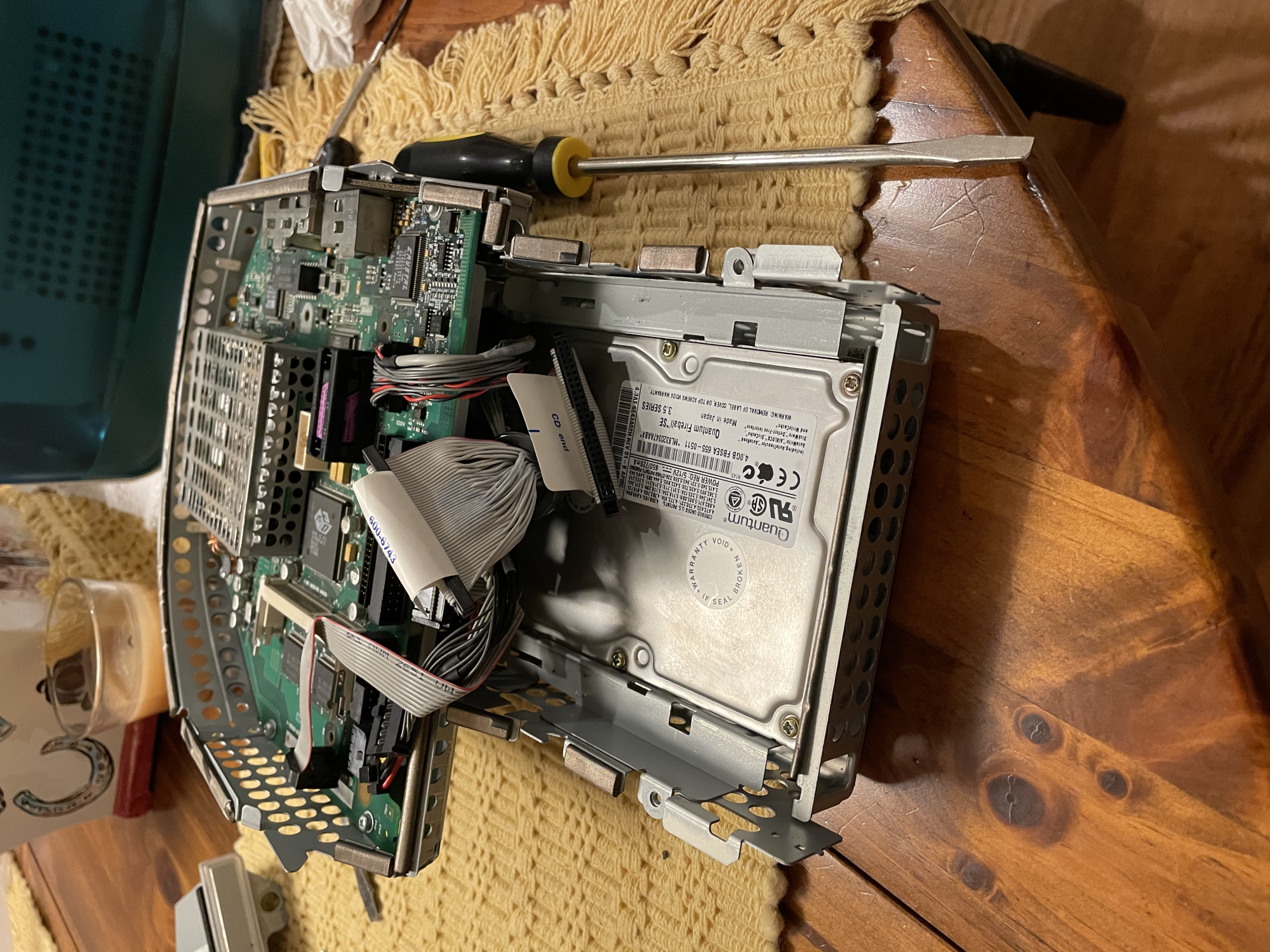

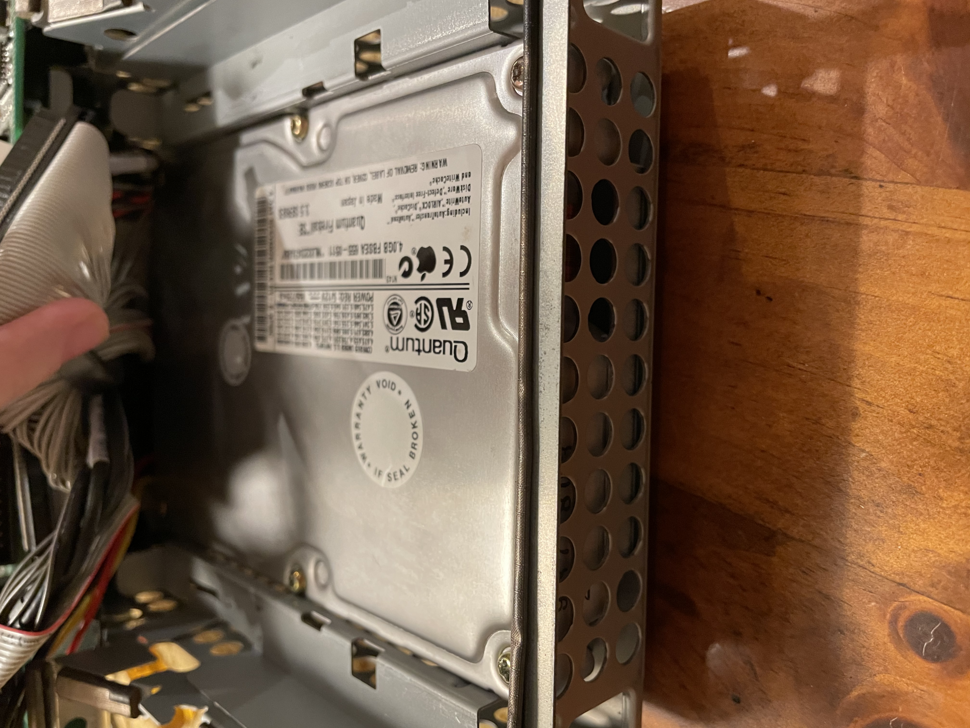

Hey everyone! So I recently wanted to replace the HD on my iMac G3 so I could use it to play some older games. However, I'm having some issues taking the old HD out. I followed all of the instructions on iFixit, but it will simply just not come out. The drive is loose at the top of it, where the two screws are on the outer side, but it seems as though it's stuck in the back for some reason. Anyone have any solutions for this?
Is it a tray loader or a slot loader? Got any photos of how the drive is mounted?
I think it's a tray loader, this is my first time repairing this computer.

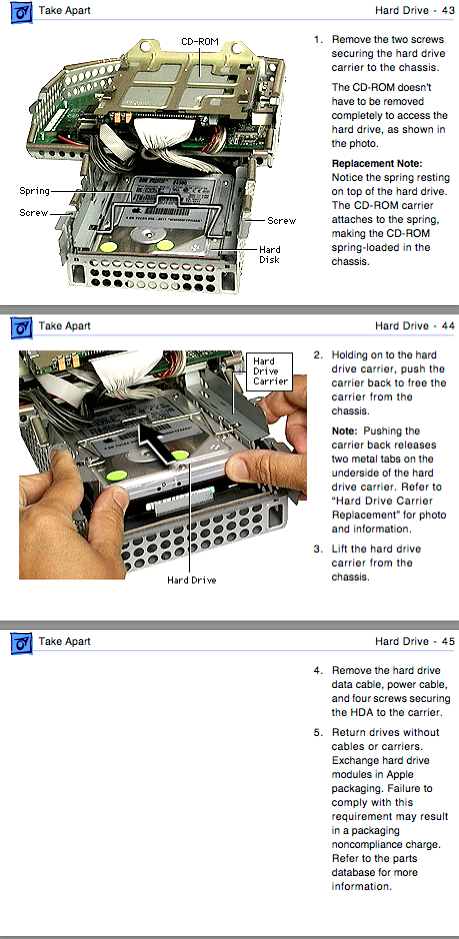

Yes, the drive needs to get "pushed back" to release two metal tabs from the chassis, then the drive should lift out.
The iFixit steps missed that step.

That's weird, it looks like the carrier is loose since it can move around so much. It seems like it has to be catching on something so you can't lift it out all the way, I'm not sure what though.
Yes, there are tabs in slots on each side near the back edge of the drive.
You can't just force up the front edge.

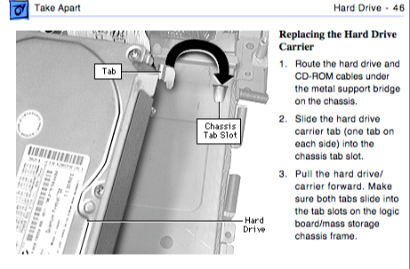

Apply pressure so the drive is as far back as it will go. You might use that big screwdriver to urge a little more movement from the front, then try to lift up the back of the drive as far as it will go. You have to try to get the back of the hard drive to move past the slots, so the tabs don't simply slide back into those slots. The last picture in the above post #4 shows what that tab & slot look like. There's one on each side.
Maybe as a hint: Don't try to lift up the front of the drive, until you have the tabs in the back released
