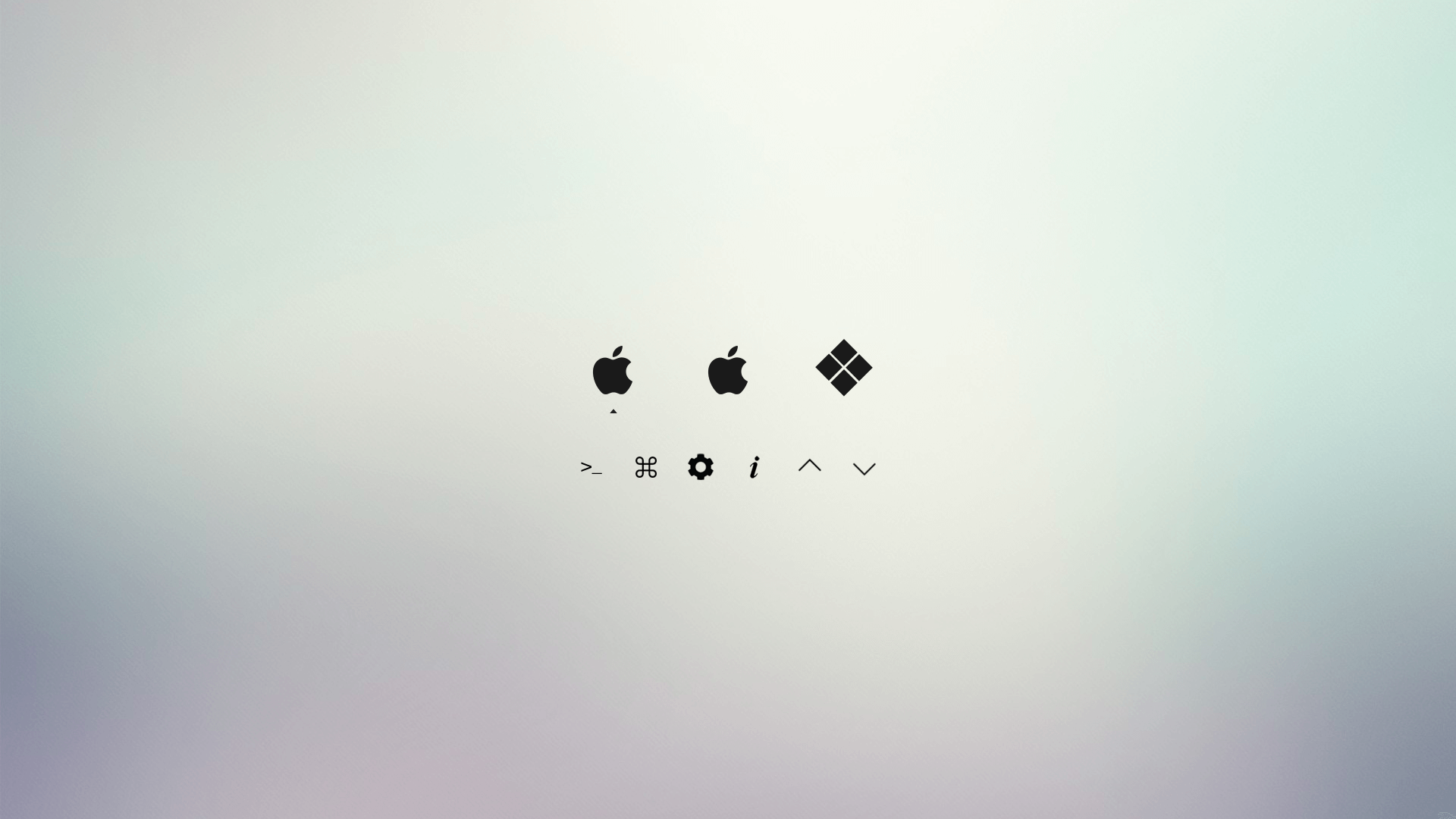

Actually what I'd really do is just install rEFInd. It is way better than holding down ALT and way better than selecting an OS from within an OS. So even if nothing was broken at all, that's what I'd do anyway just for the vast improvement.
It is also highly configurable and can be themed to look quite nice. Here is an example minimalist theme for what your bootscreen could look like.
Keep in mind that this would be automatic and quick, not like the Mac Boot Loader that requires you to hold ALT/OPTION and then takes forever.
