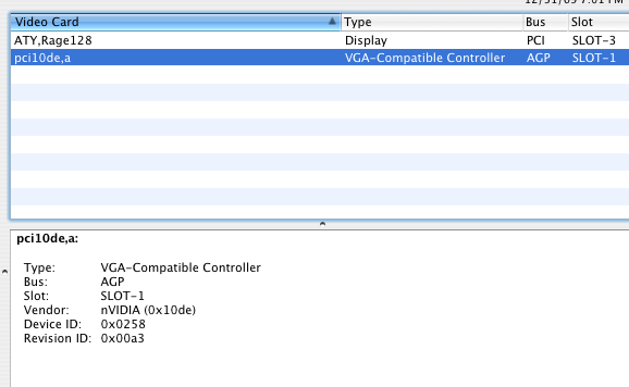

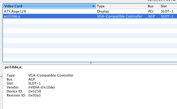

I stuck the card in my DA G4(a machine that I use a lot for this sort of diagnostic stuff) along with a PCI video card.
Under system profiler, here's how the Ti shows up
I tried to use the Nvidia flash utility to read and dump the ROM off the card, but every time I did this it returned a result of "null."
I also downloaded the OEM Ti ROM, and attempted to flash it using the same utility. I also got the "null" result.
Anyone have any ideas of what could be going on with this card? Does it look like it may have just bit the dust?

It has recognised the card but looks like it is missing an extension or so. Have you added the latest nVidia drivers to your G4?
