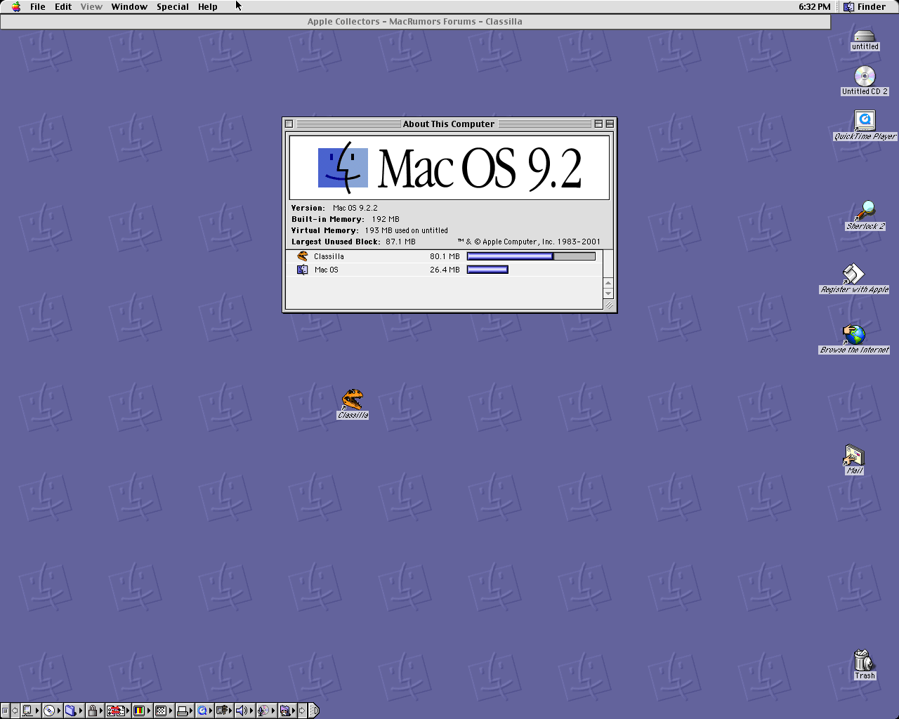

I'm happy to report that I'm typing this message in Classilla 9.3.3 running in OS 9.2.2 on my 9600.
The upgrade was definitely worthwhile. The whole system feels a lot more responsive and useable.

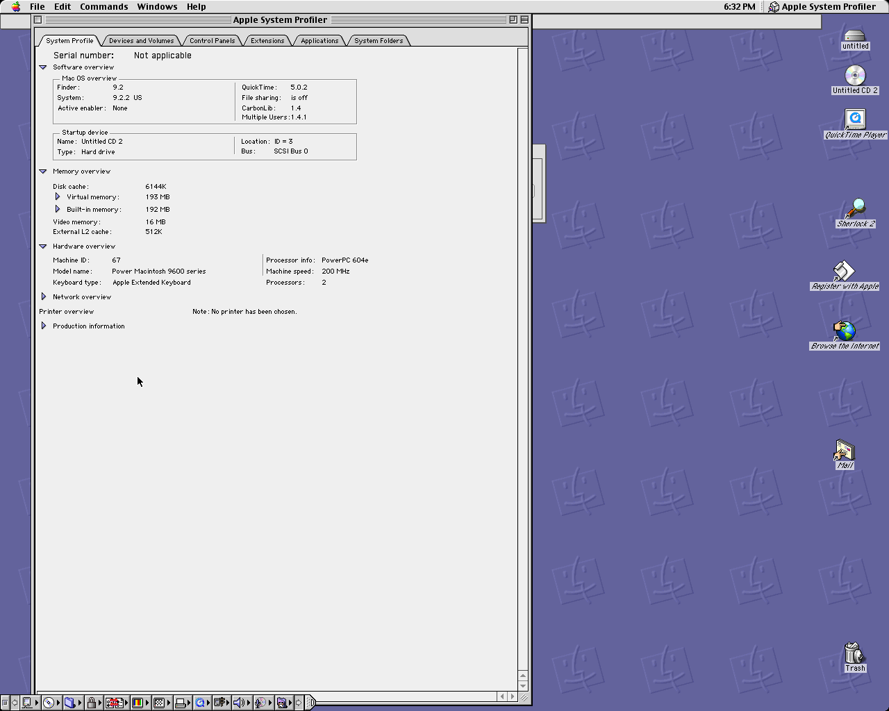

And, some screen shots since-as the current buzzword goes-pics or it didn't happen!
