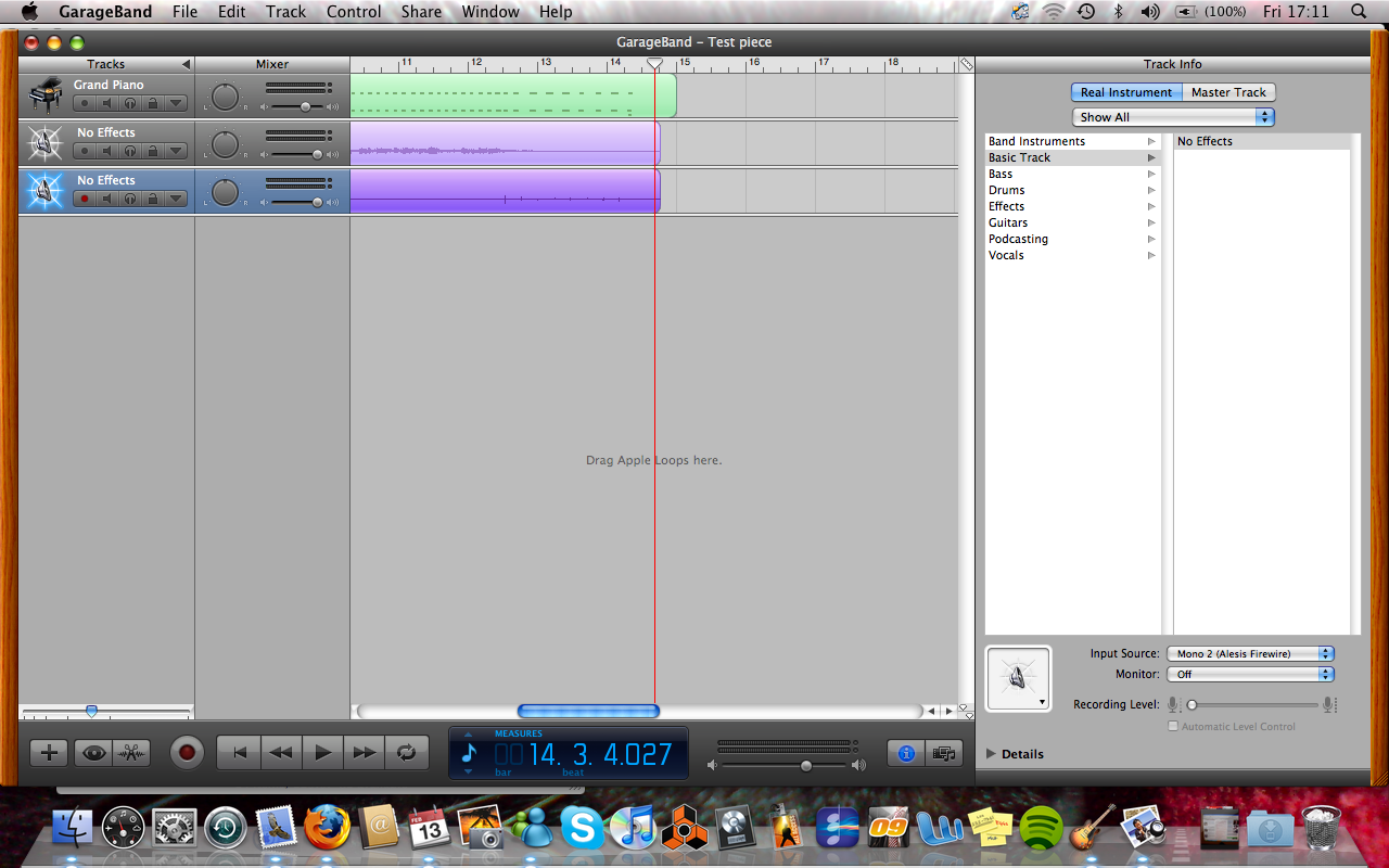

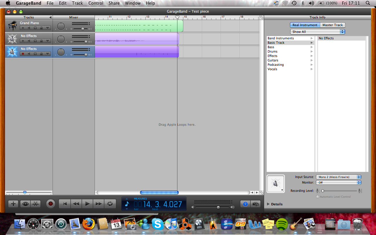

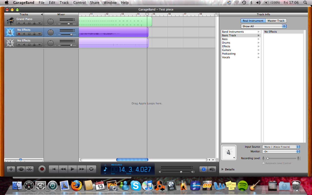

When you've got the interface set up, installed the drivers and all that. Open garageband, start a project. Create however many real audio tracks as you want. Click on the track, it will go blue. On the track info panel on the right, go to input source. Set 1 to Mono 1 (alesis firewire), then 2 to mono 2 and so on. When you record, garage band will record onto each track at the same time whatever you have put into those tracks on the interface. So you might be singing into a vocal mic which is plugged into channel 1 on the interface, track 1 on garageband will record this, then you might be playing guitar into a mic which is plugged into channel 2, this will be recorded into track 2 on garageband (or whatever track you have assigned the input source 'mono 'n'' to)
