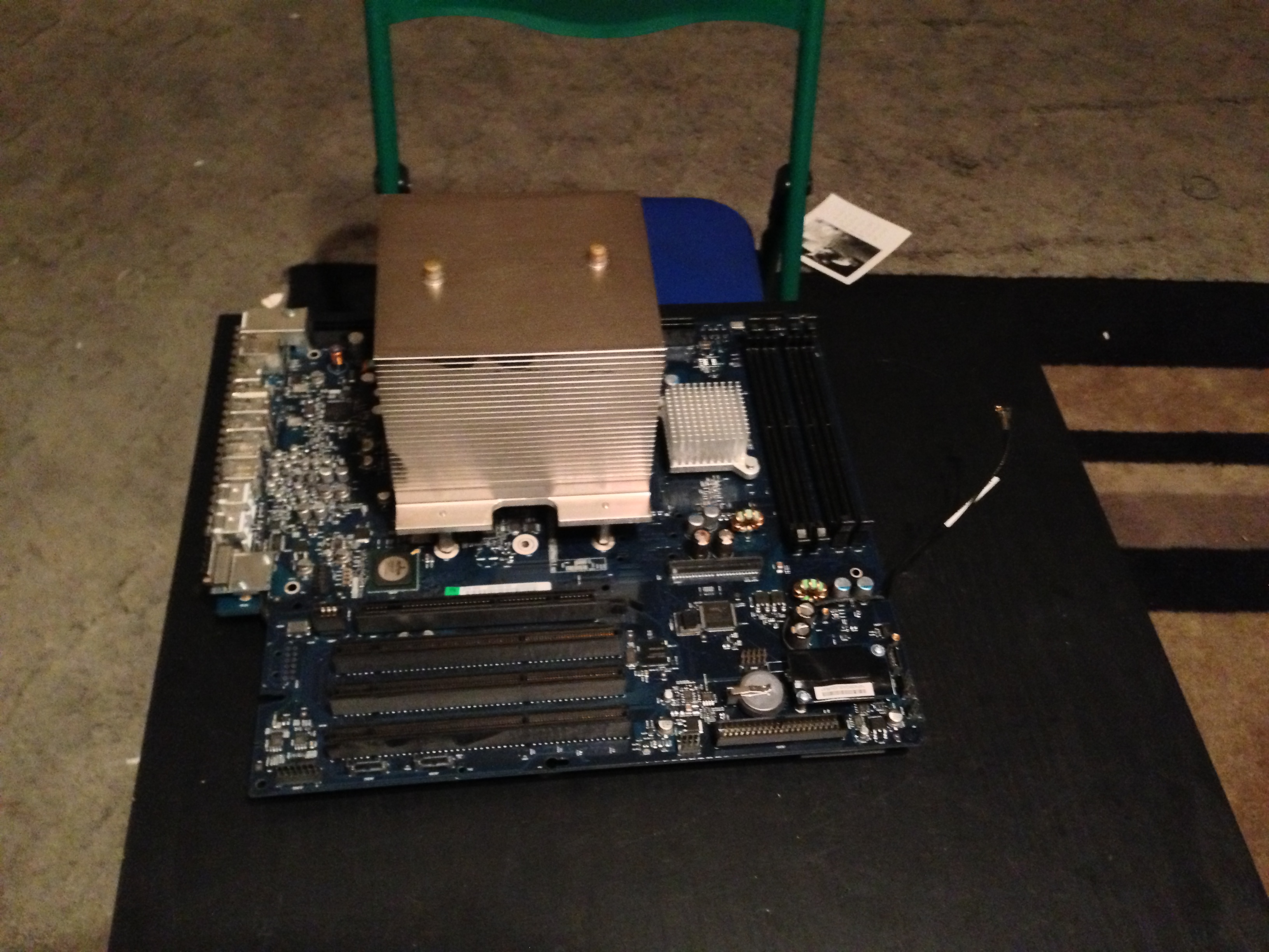

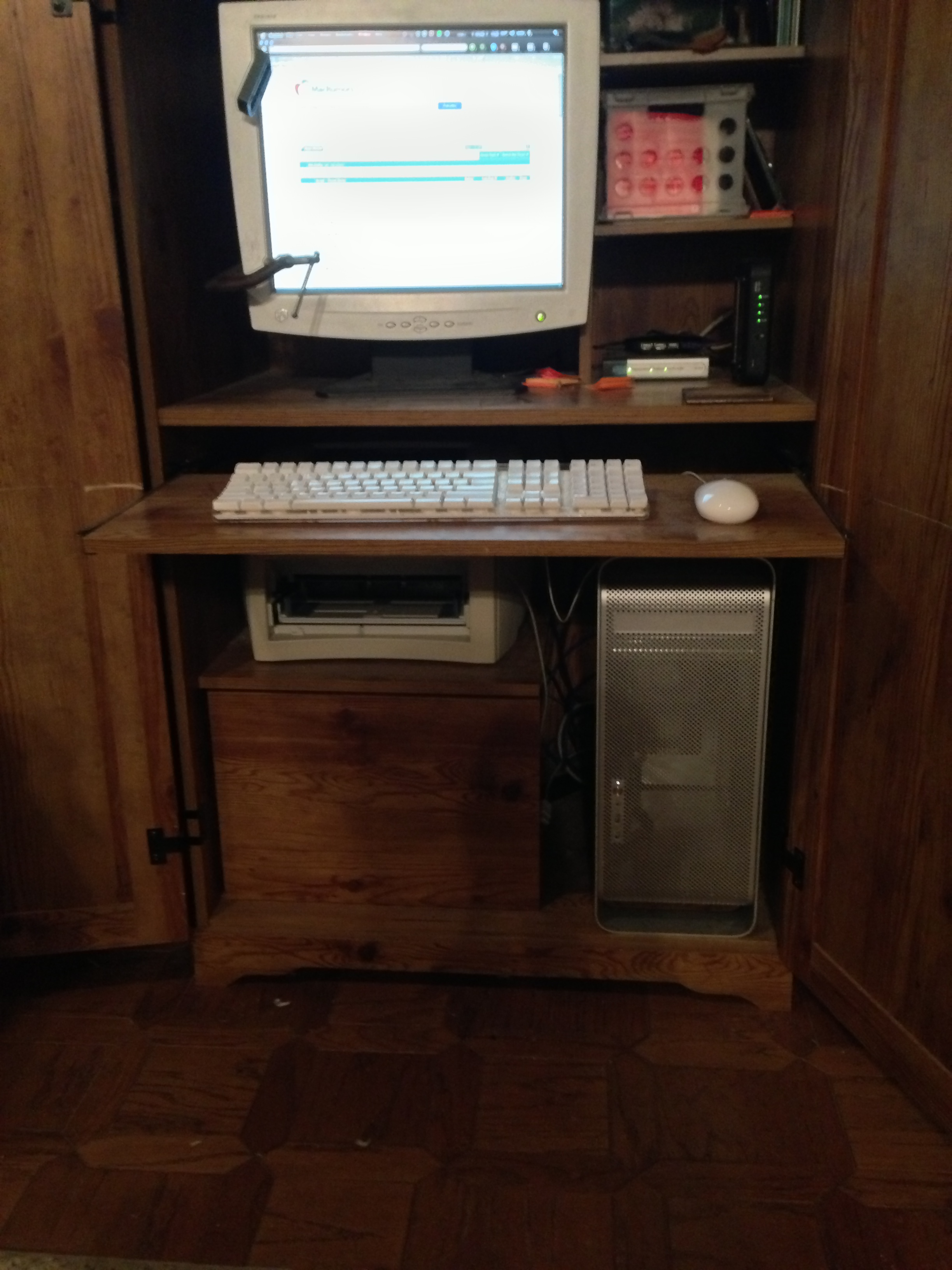

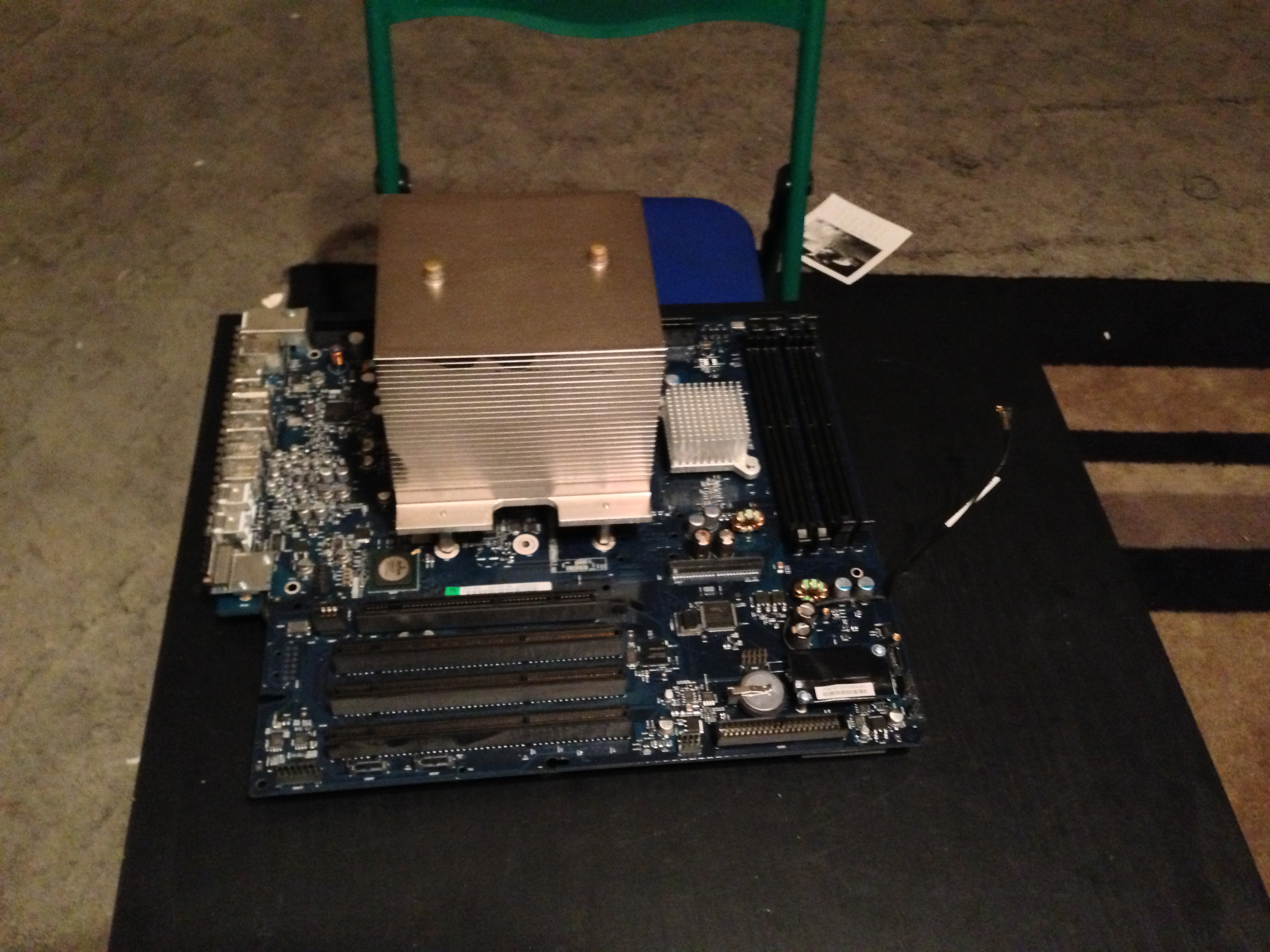

Well, not bad for a G5. $57 for the logicboard and I have a working Mac. Getting the cover off the processor was the hardest part. There's a plastic rivet you have to pull out and all the guides I looked at covered dual processor G5s. Luckily, I found a manual from a tech firm in Australia that mentioned this.
Not used to working with an X-Acto knife and a screwhook as repair tools!
PowerMac 9,1 (G5) 1.8Ghz, 2-435GB HD, 4GB ram.
The working Mac with the new logicboard and the failed logicboard below.

Yeah, I was a bit nervous. The picture I saw in the auction looked exactly like my logicboard. Only later after buying did I realize that I had an A1093 and not an A1047, which the auction was for.
I didn't realize that there was an early 1.8Ghz single processor G5 and then a later one (mine). But the logicboard that came was an A1093 and the part numbers were the same. So, very happy.
What's funny is that the NEW (used) logicboard has a serial number that indicates it was born in December 2004 AND made in a factory in the US. That makes that board OLDER than the one it replaced which was early 2005 and made in China.
