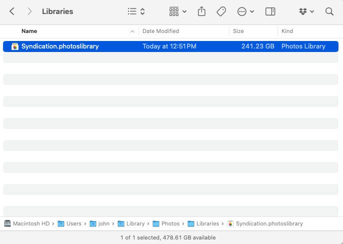

I wonder if this has to do with the bug in Sonoma where you go to User > Library > Photos > Libraries > Syndication.photoslibrary and find a bunch of old, deleted photos that are quite large in size? I've been going back and forth with Apple Support for months, and they still haven't done anything. I delete the Syndication.photoslibrary file, only for it to pop back up. If you open the library, it contains a bunch of old, deleted photos. Does anyone know if this issue is related to a bug in Sonoma?
