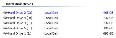

I've probably owned 10 hard drives and have used or worked on plenty of other computers, and not a single one of them has been an exception to the 1.073741824 rule. All 750gb hard drives are 698.491931 GiB, and here's proof...
I currently have a 500, 750, two 250's, and a 200 in use. All drives are Western Digital except the 750, which is a Seagate. They all fit the formula. It's a no brainer that you're not being lied to and that there isn't a massive conspiracy to give you smaller hard drives for the same price.
200 ÷ 1.073741824 = 186.264515
250 ÷ 1.073741824 = 232.830644
500 ÷ 1.073741824 = 465.661287
750 ÷ 1.073741824 = 698.491931
