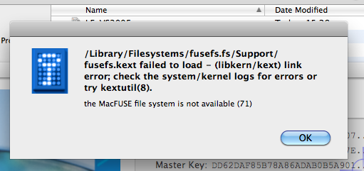

Hi,
Has anyone else been experiencing problems with existing and new Truecrypt containers on the new 2011 MBP. I have read on a forum that its related to the 64bit kernel (the 2011 MBP's boot into this by default).
The error message is attached.
I have tried all the suggested tips to be found, including installing the beta version of MacFuse, removal and re-install of the fusefs.kext file.
Thanks
Firman

Same here
Got the same problem trying to create a 10GB TrueCrypt volume. 😡
Have You managed to find a solution?
Arthur
You'll also need to upgrade your Paragon NTFS driver if you're opening NTFS formatted containers. The previous version only supported 32 bit.
OK. Thank You for the tips! Installing the latest MacFuse did not solve the problem.
I'm trying to create a MacOS Extended encrypted volume. I tried two versions (I would use it on other platforms / only Mac) none of those worked.
TC starts formatting the disk but when it ends 100% I get the same error massage as You can see in the first post.
I don't really think it has much to do with NTFS but who knows.
My Mac is new Pro 2.2 with Mac OS X 10.6.7 fresh install.

Hmm. Found the solution that worked for me.
What I understood so far:
It is indeed a problem with MacFuse that TC installs.
The version that comes with TC is not 64bit compatible and the google code version is also not 64 bit compatible.
So there are non-official mods to MacFuse that makes it work in 64 bit environment.
I've found a blog dealing with the issue:
http://www.offthehill.org/articles/2010/12/31/macfuse-for-64-bit-snow-leopard/
The package that was compiled by the author could be found here. Downloading and installing solved the problem for me... but it has made me rethink the use of TC overall.
Encryption is a highly sensitive issue. Such problems around it makes me a bit uncertain about its reliability.
Arthur

Thanks Arthur, I can confirm that downloading macfuse-core-10.5-2.1.9.zip solved the problem for me as well!

Not a solution, but a temporary work around, or a quick fix if you really need access. I just booted into 32bit mode by holding down '3' and '2' during startup. Not elegant, but works if your in a pinch.
Hope this helps someone...
