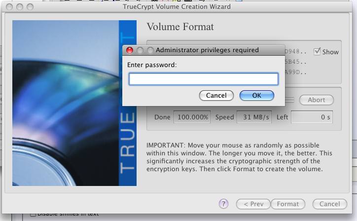

It is true. it doesn't work on my limited user account as well. Only the administrator account. It goes through the process of creating the volume but then it asks for "administrator privileges" typing the admin or the user password does nothing.

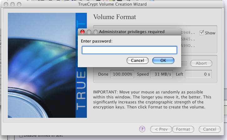

again, it goes through the process of creating it(I can see the file it creates) but once it gives me the prompt(screen capture below) It will delete it once I hit cancel. Which I have to do because no matter what password I give it(admin, user), it says it's wrong.

BTW, the screenshot doesn’t show up, only text.
You're not missing much, it's just a screenshot of the password box request for the admin password from TC.

I'll try posting it again.

I see the screenshot now. That’s weird. The password box is not the standard box that pops up on OSX. It usually looks like this
