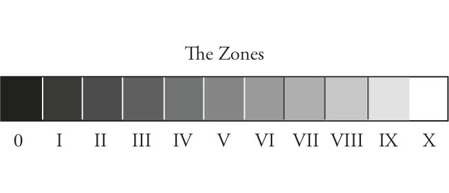

Shoot manual, and if your camera has it, use zone metering. Meter off of the skin tone and adjust your exposure based on it. Yeah...we're talkin' the Zone System here, but it works. Zone metering meters to 18% gray, or Zone V. based on that, if you're shooting someone with Caucasian skin, you'd over expose 3-4 stops. If you're shooting Asian/Latin skin, perhaps overexpose 1-2 stops. If someone with Black or Indian skin, under-expose 1-2 stops.
