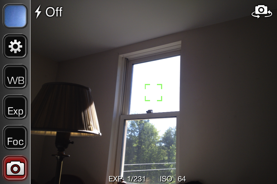

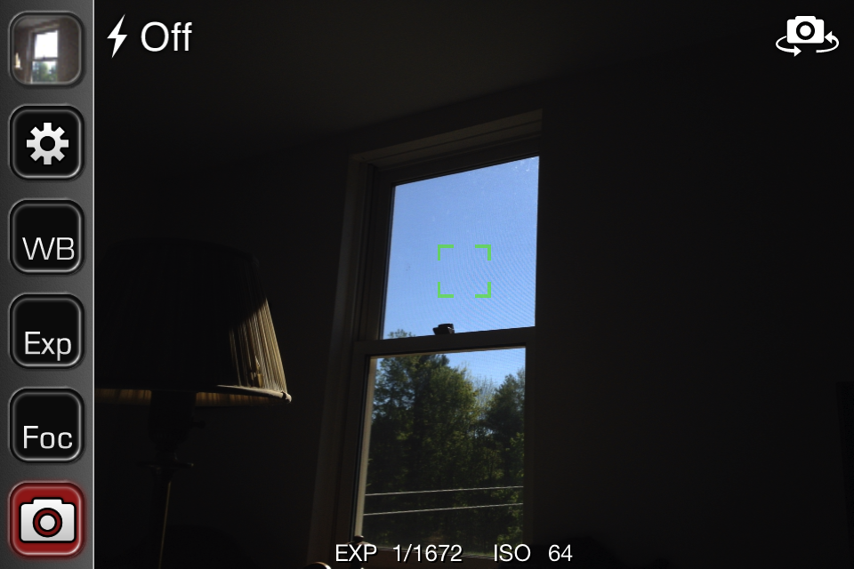

Here’s something I’ve noticed: the auto-exposure in NightCap acts differently depending on whether the focus square has been manually placed.
The biggest difference I’ve seen is when I’m sitting inside, pointing the camera out a window at the bright blue sky. If I have just started NightCap and the focus square is in its original state, then the picture is overexposed and the sky appears white. Right now I’m seeing it go to 1/231s at 64 ISO.
However, if I tap to move the square even a tiny bit, then suddenly the autoexposure becomes much more sensitive and the sky becomes a rich cerulean. In this case, the exposure goes all the way to 1/1672s at 64 ISO, even with the focus box pointed in the exact same part of the sky. That’s nominally more than a 7× speed increase, and the results make that seems plausible.
On the left is what I get leaving the focus square untouched; notice how it is overexposed for where the target is. On the right, after I touch the screen to set the target, the target is exposed properly:
The difference seems to be how big an area the auto-exposure looks at. At least, there is no difference when I actually go outside, I only see this happen when most of the picture is dark but the target is in a bright area.
It would be nice to have a setting to control how large a square the auto-adjust looks at. In any case, the default behavior when the target is untouched should either match the proper behavior when the target is touched, or there ought to be a way to revert to the untouched exposure state without having to quit the app.
On an unrelated note, if it’s possible to determine the current distance at which the camera is focused, it would be useful for that to be displayed next to the shutter speed and ISO. Same goes for temperature of the white point. So, “1/6s, ISO 100, 8.5m, 6400K” or some such.
On the left is what I get leaving the focus square untouched; notice how it is not overexposed for where the target is. On the right, after I touch the screen to set the target, the target is exposed properly:
Looks like the exposure mode isn't being set correctly at startup - I'll check that. Actually while I'm at it I'll have a look at the exposure modes again, it might be possible to switch between spot (which is what nightcap generally uses) and auto (which is what the camera app generally uses).
Yep, I'll investigate. Last time I looked at this it seemed that it was possible to set it to spot mode, but not to set it back to auto - but I think I know why now, so maybe this is possible.
