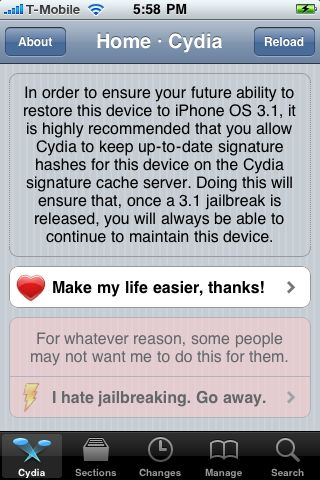

Is saving the SHSH part of the jailbreak? Or does that have to be done as a separate operation? That is one point I think I am a bit fuzzy on. Thank you for your answer.
Its done after you JB.
As soon as you open up Cydia for the first time a page like the one bellow will appear.
Make sure you click make my life easier and not the "I hate jailbreaking" button 🙂
You seem like you researched plenty and you're ready for it.
Good luck. Glad to see people actually do their homework before getting into this JB thing.

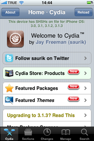

Actually I just read it thru and you are gettting it JB already.
So hopefully the previous owner clicked the "make my life easier" button.
And no you cannot restore to anything but the latest 3.1.3 unless you have your SHSH's saved.
So when you first turn on cydia look at the top of the page. It will list what firmware cydia has your files saved for.
Then by following this you change your hosts files for itunes to redirect to cydias server.
http://www.iclarified.com/entry/index.php?enid=7557
But if you dont need to restore to 3.1.2 firmware you dont have to.
Just leave it the way it is.

Hmmm, so it looks like I really need to turn on Cydia and see what version it has my firmware saved to. If it is 3.1.2 I am in good shape, anything else is not so good. We shall see. Thank you for your guidance on this. There are some rather subtle points and you are helping to clarify them.
