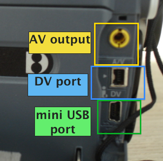

The only ports I see on my laptop are USB, lightening, and HDMI. Plus a long slot that I guess is for a memory card? I tried using a plug into that bottom slot (in the photo) with USB on other end into my laptop, but iMovie could not find it. If I had the plug for the middle slot, going into USB, would that work?

That middle port is firewire, - Sony called it "iLink". I think your MacBook pro must have a thunderbolt port. Is that what you meant by "lightening"?

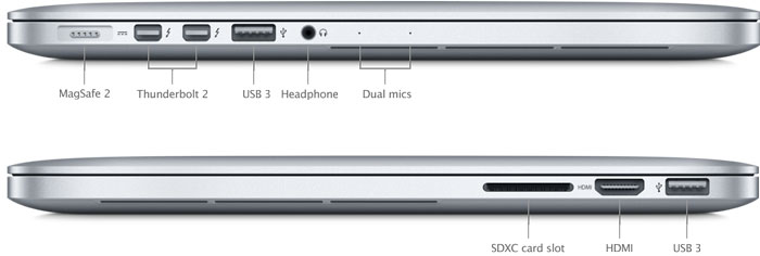

I think they are regular Thunderbolt slots. I use those kinds of slots regularly on my iPhone (6) and iPad for charging, but rarely if ever on the MBP.
This has me a bit confused. You would normally use a USB port to charge an iPhone. This is what the thunderbolt ports look like.
No, I mean my iPhone and iPad have those slots. Sorry for the confusion. The part that goes into the computer for the charging is of course the USB plug.
I'm glad you posted that picture though because it helps to see the labels for the slots again.
[doublepost=1506279703][/doublepost]Ok, so it looks like I'll be getting the Tripp Lite FireWire 800 IEEE 1394b Hi-speed Cable (9pin/4pin) and attaching it to the Apple Thunderbolt to FireWire Adapter which then plugs into my MBP's Thunderbolt slot. That small end on the FireWire does look like it would fit into the middle (DV) port on my HandyCam.

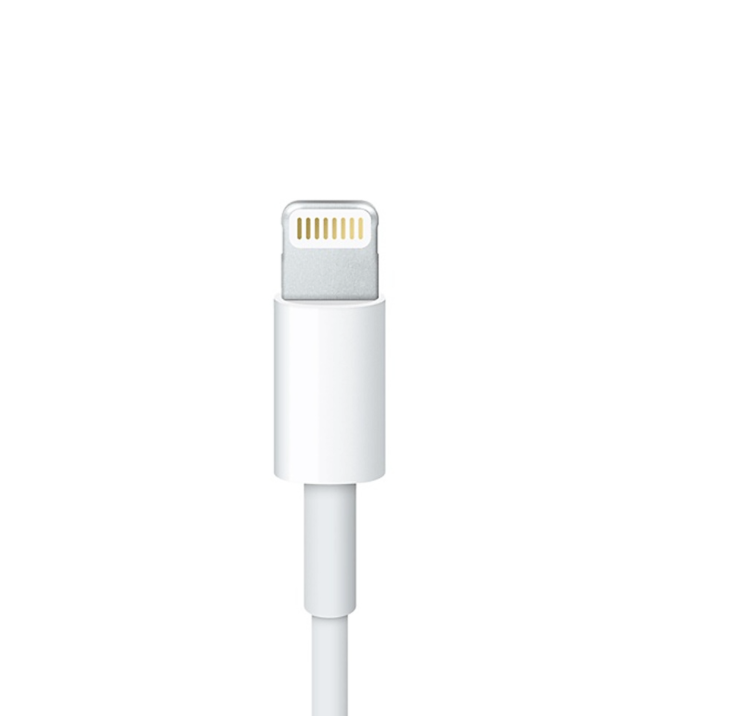

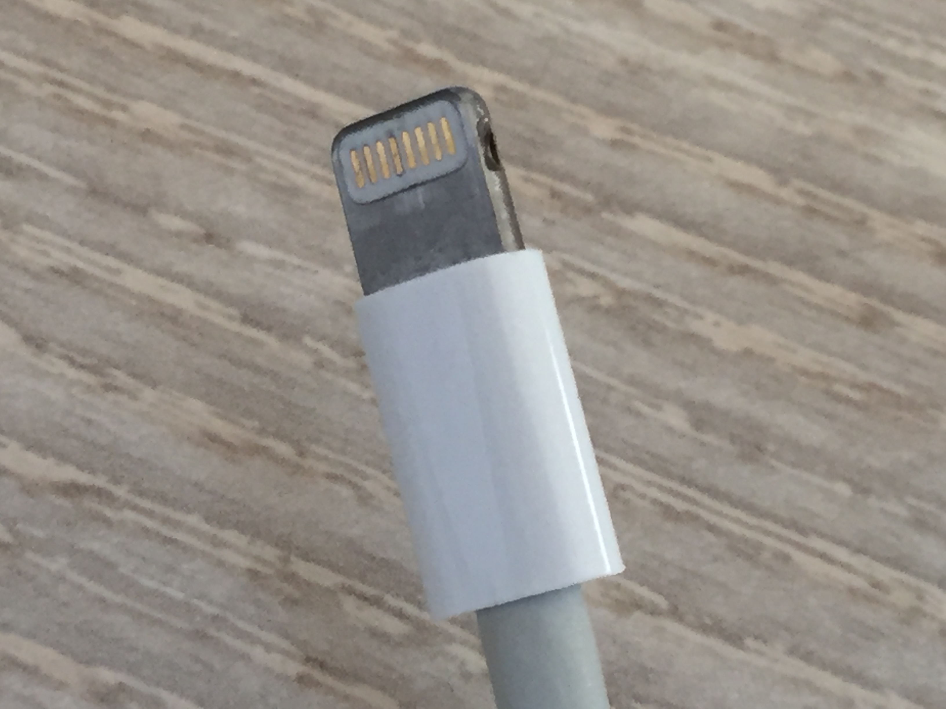

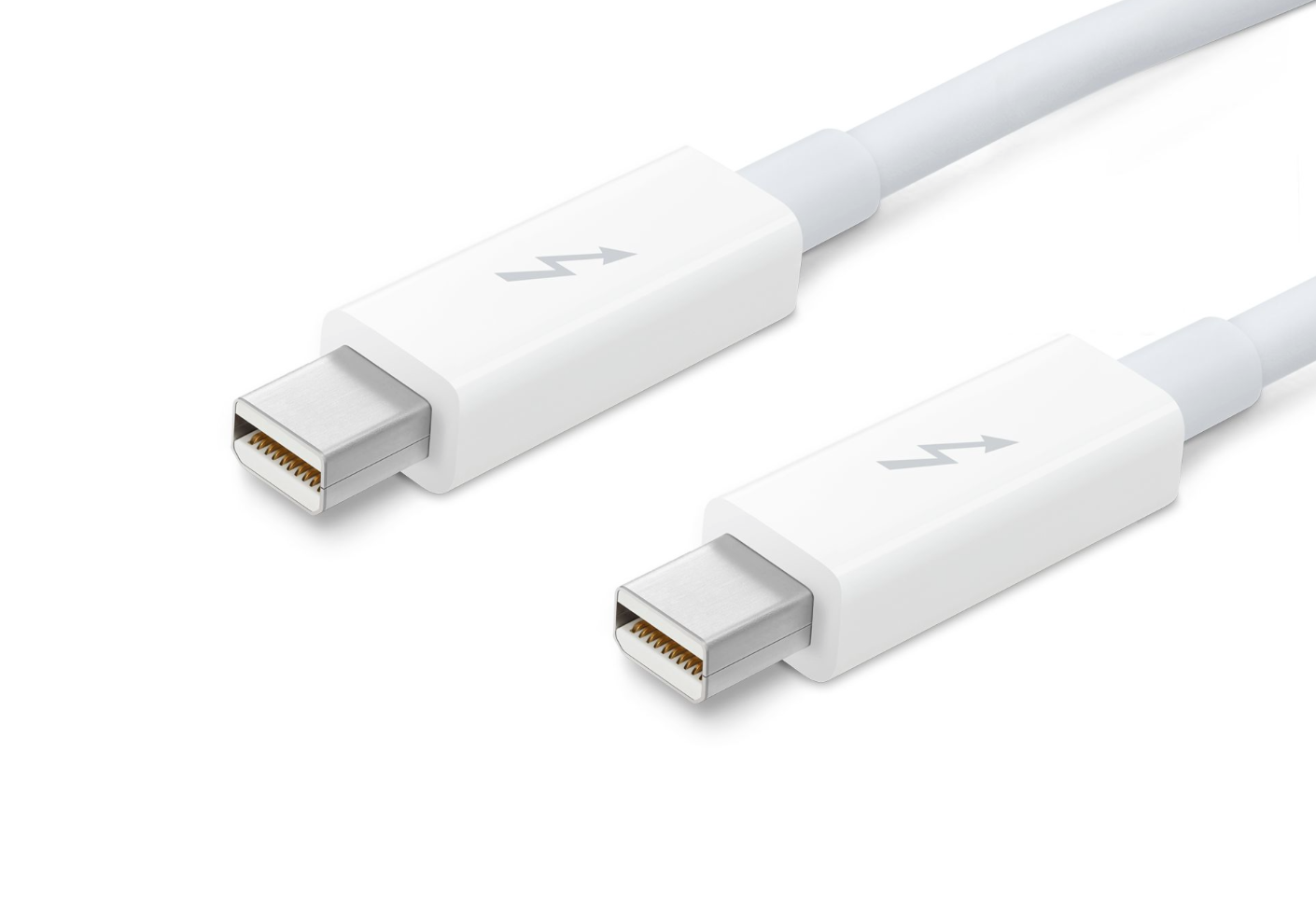

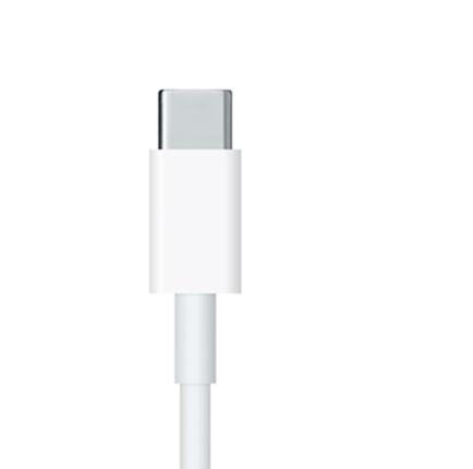

The lightning plug that fits into your iPhone is not the same as the TB2 plug. The TB2 plug is much larger and different (not two sided). The TB3 or USB-C plug is similar to the lightning plug.
TB2:

TB3/USB-C

Lightning
Easy to understand how you were confused, Apple puts a lightning bolt icon next to the thunderbolt ports, then they call the plug on the iPhone a "lightning connector". But of course they are very different.
