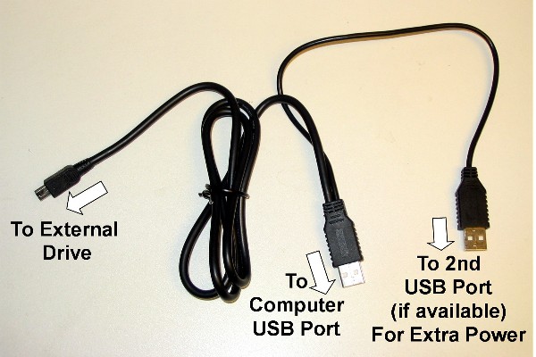

Tried both USB ports on the PowerBook? It looks, like there is not enough power coming from the USB port you have tried with, thus the clicking.
Same result off both ports unfortunately
The try a USB Y cable like this.

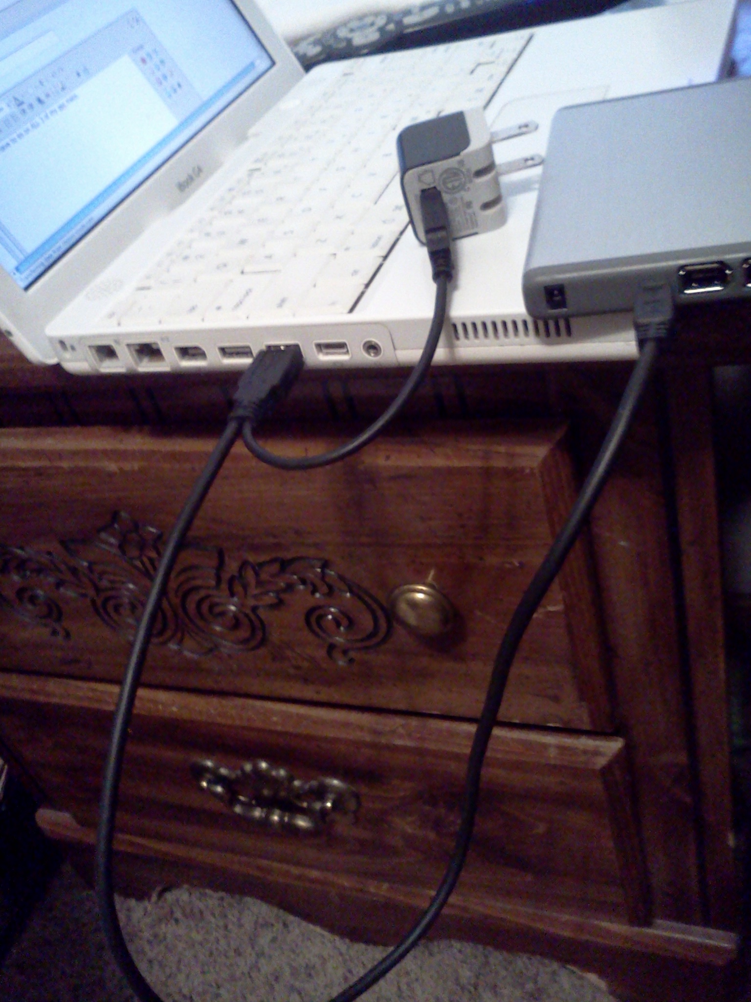

Here is what I have to do on ALL 3 of my ppc macs.Obviously not plugged in but you get the idea I guess it is a power issue as I am forced to do this with my external usb drive as well.

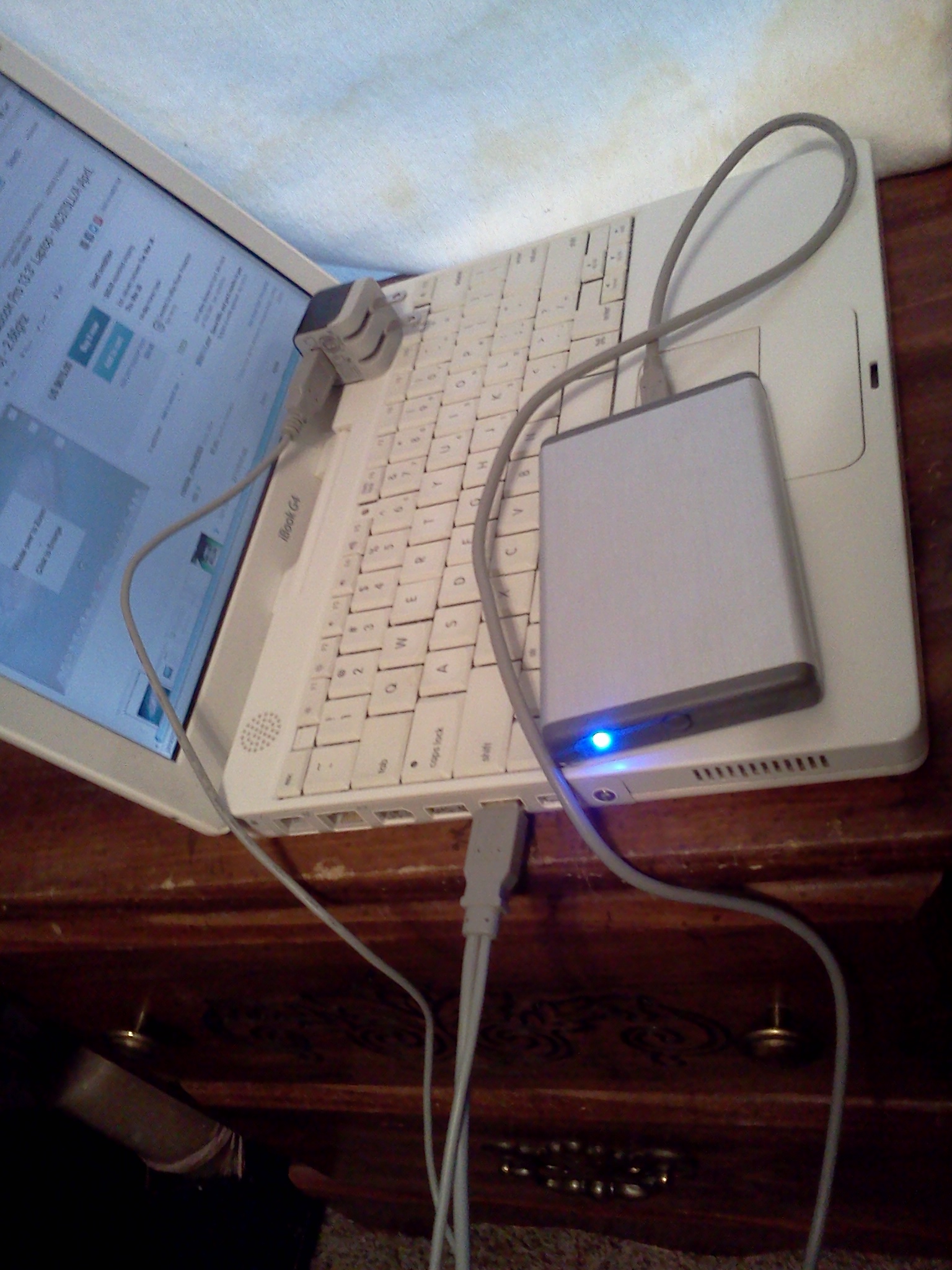

The hard drive case in the picture is an acomdata brand it's on ebay for $11 and as eyoungren said hard drives are pretty cheap that external case also has two firewire ports all I gotta do is hold down the alt/option key upon start and I boot linux from it almost daily and its the same finish as the powerbook so they go good together.
Nice idea. I just wish the extra/2nd usb cord wasn't so short.
Solutions to everything lol this one is the one that came with the hard drive the black one is to my lg external burner I just used it for example I've also ran an extension cord to it.I mainly just use the ibook for a dvd burner and other things so it pretty much stays on the desk all the time anyways.
