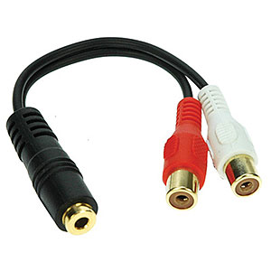

Looks like the third adapter with three A/V jacks is female. One of the other two adapters would have to be male.
I have no idea what that means but you are probably right. Got both cables in the mail and it aint workin : /
think about it. basic organic design.
Male RCA:
Female RCA:
Male into female.
