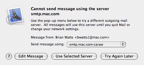

I have a 32mb clip (from my digital camera, using quicktime to open), but I keep getting this error message when I try to send it: Mailerror.jpg.
is it too big, if so how do I go about converting or reducing it?? I do have QT Pro. Any thoughts or advice would help.

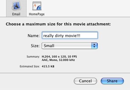

Since you have QT pro, open the movie in QT and select share from the file menu. You'll see a choice for email and homepage. Select email and use the drop-down list to select the best size.

Yes its compressed- check where it says summary.
using the picture two posts above;
your "really dirty movie" would be compressed using H.264 codec at 160x120 pixels, 10 frames per second.
Audio is AAC compressed in mono at 32.000kHz
