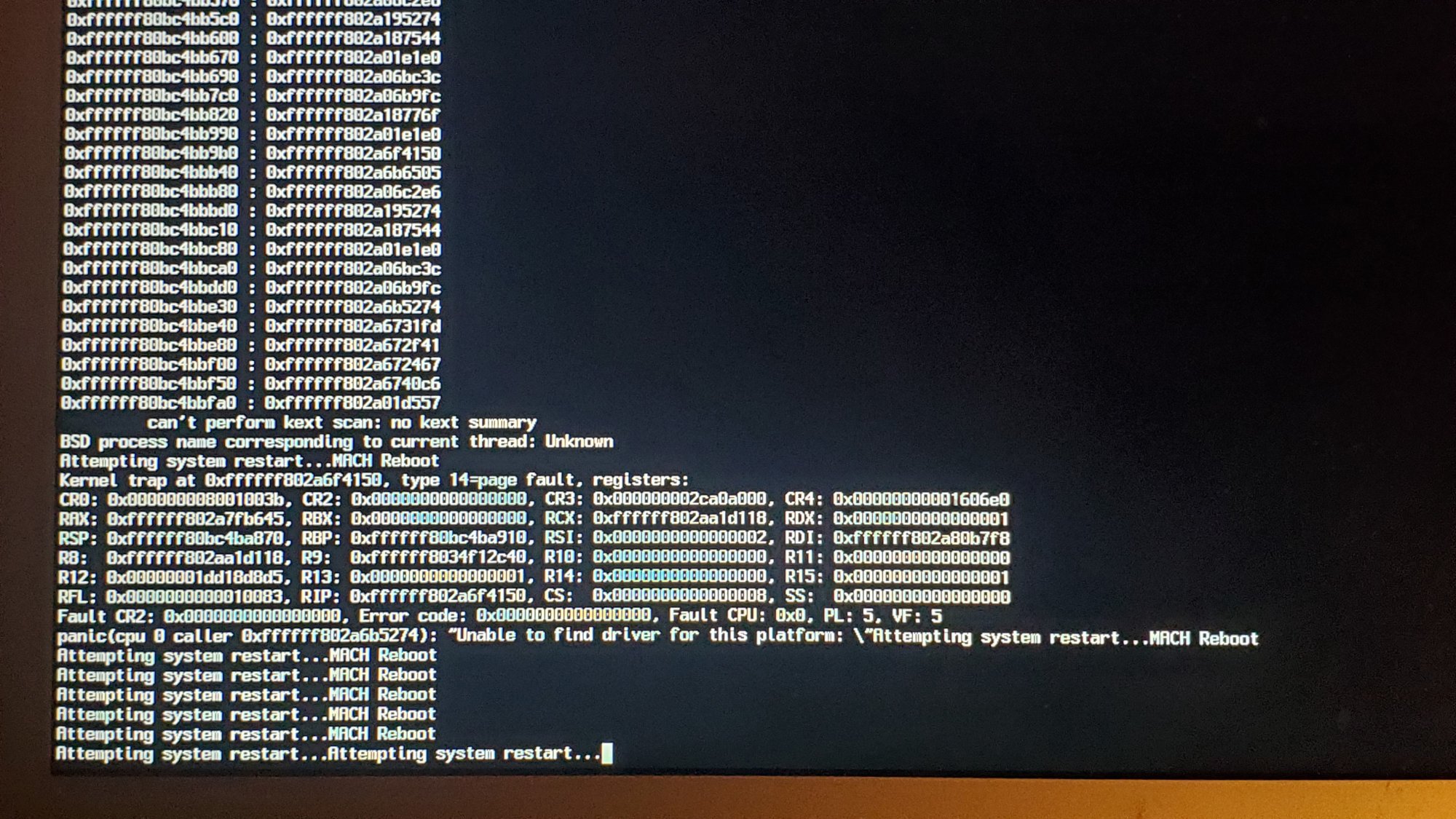

When I boot into verbose mode, I get this. (See attachment). What's next? View attachment 950634

If you ran the AHT and it is reporting a problem then it is probably not a software issue. It does appear that 6002d is related to the RAM.

However, the OTHER error, when you try to boot to the Diagnostics, is sometimes a RAM problem. The RAM is soldered onto the board, so you would be stuck with that (unless you have access to circuit board repair skills and equipment)
Its possible for the mac to boot into any gui with ram issues? As far as I'm experienced, when a pc has ram issues, a system won't even post.

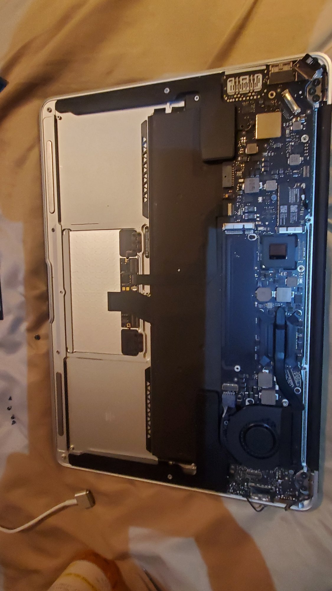

My battery is definitely missing. So... Another update. I've removed the logic board to get the memory type and I found the nand flash. Some small town in China has a quantity of 165000 of them.. and would only sell them in bulk. This is the only place I found the original modules from. So... I'll continue searching for them.
