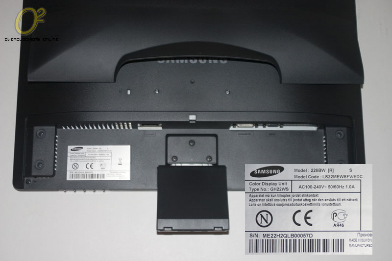

Look on the back of the monitor, there should be a label with more information.
And what about the resolution shown in System Preferences > Displays for the external display?
Yeah I noticed that soundbar too, I thought it might have been the same number because it's bundled in with the monitor. It looks like the monitor is a Dell 1905FP.
