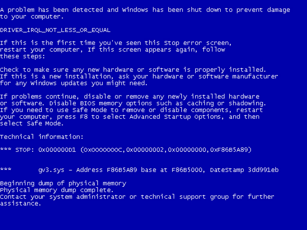

Well, I have just installed XP via parallel, and after I have formatted the disk and finished the bluescreen installation, it started to count down and restart.
So I stop the Parallel and restart Mac to boot as Window, but it wen to a black loading screen and then blue error screen which you usually have in windows
Like this one
e.g.

Finished installing and ended parallel, then I reboot the physically drive (restart and starts as windows)
got to the bit where the Windows XP logo appears for a second then it got to a blue screeen and automatically 'power off' half a second later
*sigh*
Try holding down F8 (maybe fn-F8) during the initial part of the boot, to try the safe mode boot as it suggests. This might get you past this point.

safe mode didn't work, it loaded as how it should load when booting from safe mode, then it crashes again (blue screen+shutted down)
