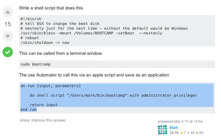

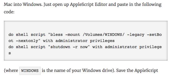

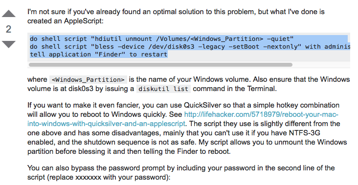

So I am running in circles trying to get this to work and was hoping someone here would be of help.
I want to create an application icon of an applescript so i can just click it to boot into bootcamp.
Here is the info I have found but I have tried a few different things (using quicksilver, using alfred, doing it manually) and I am coming up empty.
Anyone have better directions on how to pull this off?
I attached some images of things I have tried to do.. most likely my implementation is wrong and the scripts are fine.
Any help would be greatly appreciated.
Thanks,
Dave
