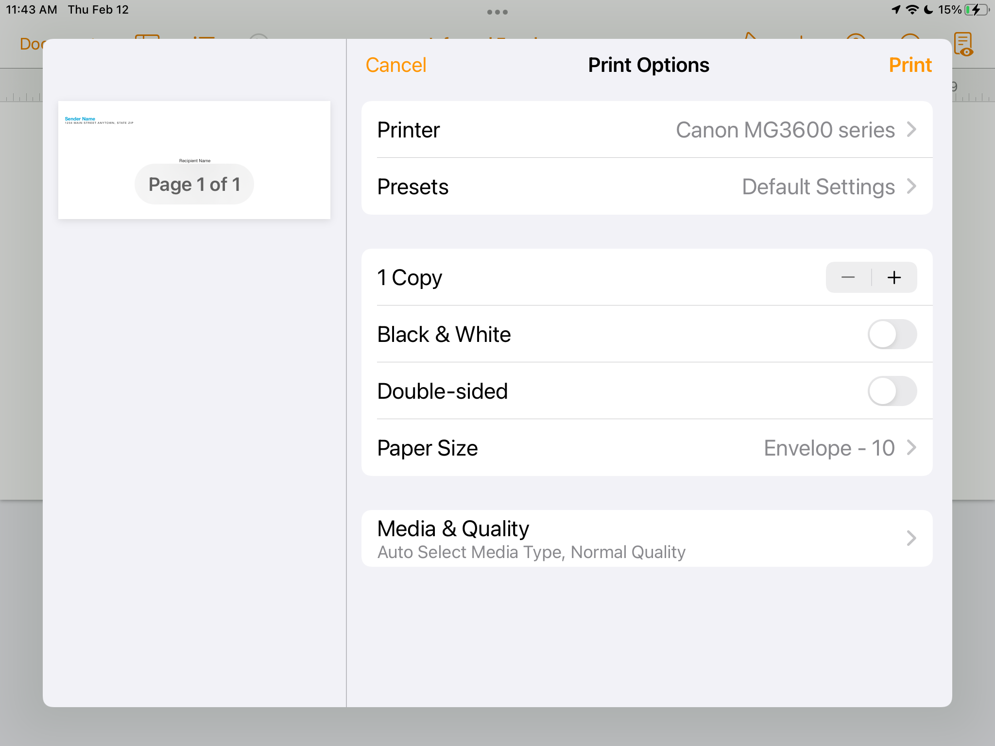

would help to show pictures of your print dialogue box. Could be you are feeding the envelopes from the wrong edge or there is something setup incorrect in your page setup.
I’ve copied an image with #10 envelope selected, but I’ve also tried it with other settings and get the same result: A blank envelope. Using a plain 8 1/2 x11 sheet works fine.
