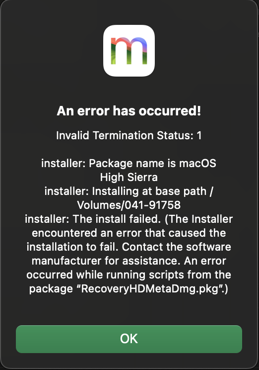

For some reason, the MBP wouldn't accept Catalina or Mojave. It was the same problem I had before, where it gave the "prohibited" circle with the line through it. And High Sierra kept coming back with an error whenever it got to creating the install in the disk image.
