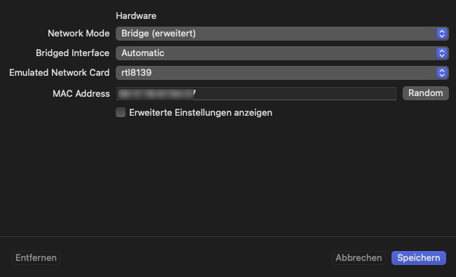

I change Network in UTM Settings to Bridged because i get a dedicated IP from my Router this way:

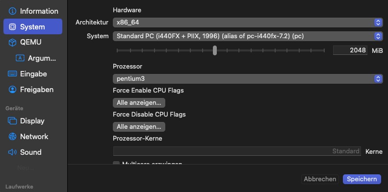

I changed the CPU to Pentium before installing with FAT Filesystem because i had the Access Errors but they came from NTFS:
And changed RAM to 2GB.

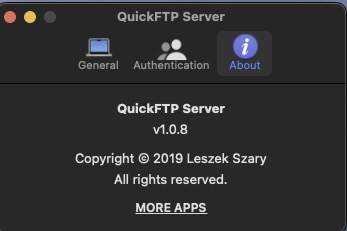

Because WinXP is so Freakin old and the SMB Version does not function (showed up but...) i had to start my little FTP Proggy on the Mac called QuickFTPServer:

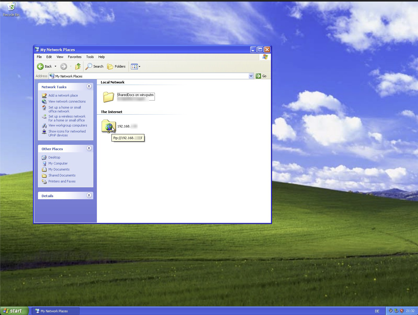

and could access my Desktop via ftp://192.168.x.x in the Explorer Filebrowser.
