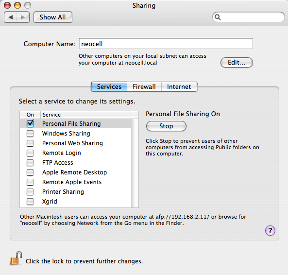

Apple fix:
When you set personal file sharing you should get a URL address "afp://blahblahblah" coming up at the bottom of the Personal File Sharing window. Try putting that in the URL window in Safari of the other computer and it "should" see the first computer.
***2nd EDIT***
Made things a bit clearer 😀 Crap image what the first edit was like

have you tried using the afp:// address that comes up at the bottom of the system prefs window in Safari of the other machine? If this still doesn't work I'd try calling the router support guys and explain the situation to them
